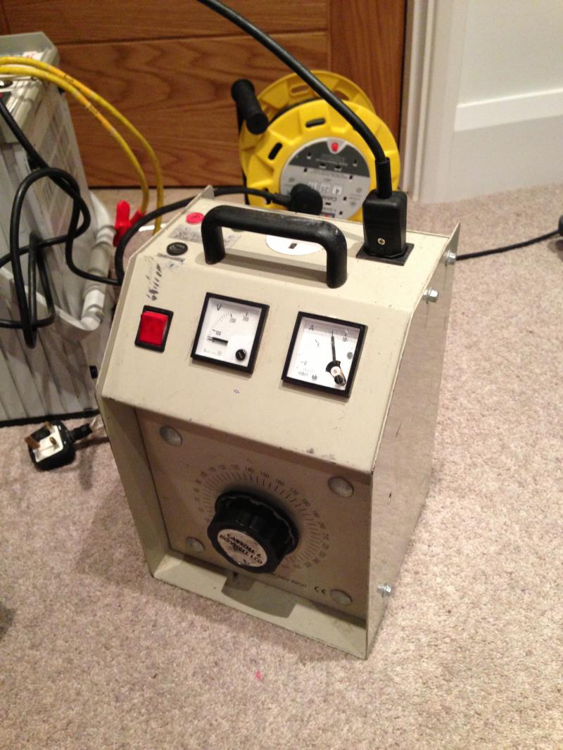

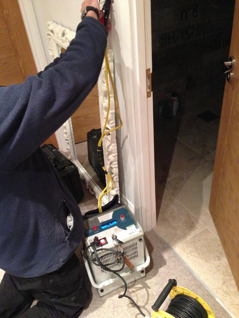

The engineer visit was successful. He traced the fault and we were able to lift one tile and cut the mat at that point to fix it. The fault was 1m or so from the tail end which ran down the side near a wall so wasn't really required. Hence being able to cut the mat tail there rather than splicing in a new section.
I have relaid the tile and have a nice warm bathroom floor again. :)
The engineer could not see an obvious nick in the cable where the fault was so it has preliminary been put down as a manufacturers fault. Further analysis is to be carried out at the factory to confirm.
I took a couple of pictures of the tools used to trace the fault...
First a current was passed down the cable to make the fault (fusing of the load and earth wires) worse.
Then heated up the mat using this machine (High amps, low volts) which meant we were then able to trace to fault using a Thermal Imaging Gun (£9k apparently!)
Very helpful and knowledgeable engineer.
