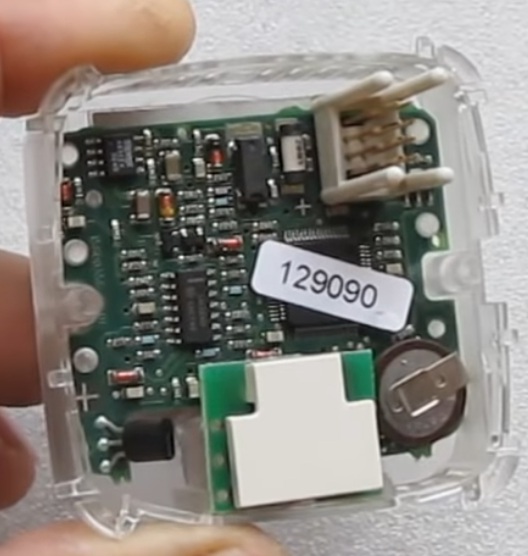

Hello, I have Deviger 550 thermostats in every room and I have noticed that during a power cut some of them present a flashing ring with NO fault code. All the programming seems to have been retained apart from the clock time which reverts to 00. If the button is held in and the clock set to correct time the thermostat works ok. Any ideas on this and also how to change the rechargable battery. Thank you all.

None of the articles mentioned a replaceable battery - I suspect it is possibly a lithium cell soldered on to the PCB.
OP, how comfortable are you with dismantling electronics?
Otherwise, you may have to live with the error for every power cut (hopefully rare! :confused:) or get a new DEVIreg touch?
Yup,
It's a soldered on Lithium cell (non-rechargeable):
You can see it @5:00 mins in this video (not in English but you get the gist! :))

I should have said 'looks like' a non-rechargeable soldered on lithium cell. It could easily be a Li-Mn cell that is rechargeable, but impossible to say without removing the battery.
Given the expected lifetime of these products and the 'non-user replaceable' nature of the battery, I doubt it would matter whether it was rechargeable or not (How often do we need to change the CR2032 in a PC)!

Definitely rechargeable, but assuming it has been continuously connected to the supply, also probably definitely dead!
