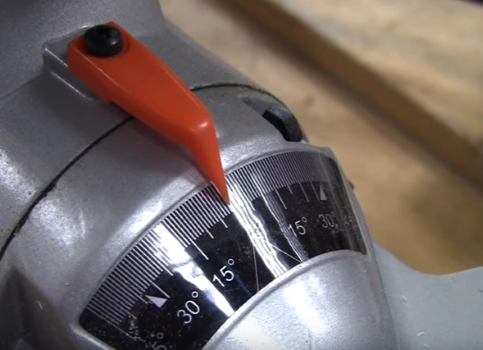

I personally find the bevel angle scale on the DW717XPS (left) to be a lot easier to read than the Makita (right):

although the scale on the newer LS1019 (below, and the very similar cordless DLS110) are a further improvement and incorporate a Festool-like fine adjuster control at the front of the saw (the know is just visible in the top right corner here):

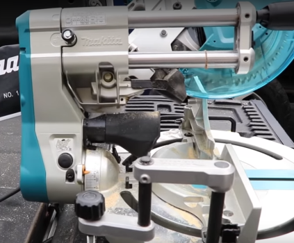

Note how little back overhang there is on a double rail set saw - very handy for site use and when moving kit around.
