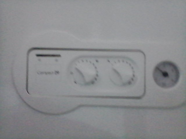

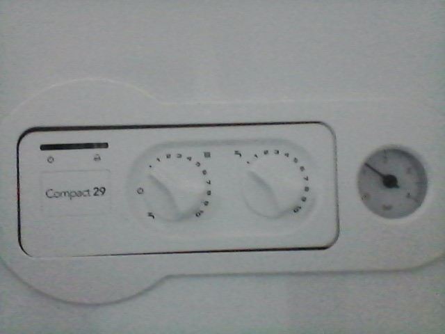

Hi I have attached a picture of my combi boiler sorry it isn't very clear. The left side is the radiator dial and the right side is the hot water dial. The water isn't very hot in the bathroom and it is odd that when I turn the sink/bath tap fully the hot water is cool yet when I turn it halfway the water is hotter why is that?
I need to know how far should I turn the hot water circle on the boiler from 1 to 10, would it be dangerous to turn it all the way to the fullest level?
Any help would be great and does the wireless thermostat have anything to do with the DHW or just the CH because I can't figure it out at all!

Turn it up all you need. That is why it's there.
Try running your tap at around 11 litres per min
The official recommended temperature for hot water is 55 C to 60 C as that kills legionella.
But a little lower is not a problem.
I like it at 45 C I can shower directly in the 43 C that arrives in the shower.

Thank you for the info so far, on the DHW dial which number would be about 55-60 degrees Celsius? (1-10)
Also on the boiler is the cold water inlet stopcock meant to be turned fully anti-clockwise because I turned it is all the way clockwise and it turned the hot water off and now by turning it anti-clockwise I don't know how far am I meant to go? Help please
Open the cold inlet fully. Turn the dial up to at least 7-8 and see how hot it gets, best gauge is by hand I find, make it as hot as you need it, just remember if there are any kids or older residents as they are more susceptible to scalding. As the colder weather hits you may want it all the way to 10 and turn back down when winter's over, it needs more heat as the cold water temp drops during winter.

The risk with hot water and legionella is when it's stored and how long for. In a HW storage situation then it is advised to store hot water above 60Deg and distribute it above 50Deg, higher if the user is within a higher risk category and then you get into TMV2/3 territory.
In a combi system, as the OP has suggested they have, as it is mains fed instantaneous hot water, the legionella risk wouldn't usually come into play anyway.
