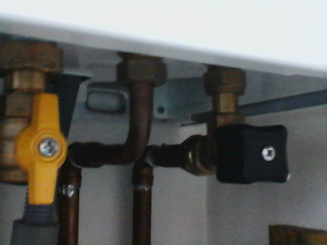

I ran the hot water tap in the bath and it filled an 11 litre bucket in 50 seconds is that okay? The only thing which turns on the boiler pipes is the cold water inlet stopcock nothing else that I can see. The cold water inlet stopcock (picture attached) seems to control the hot water pressure throughout the flat, when I turn it all the way clockwise it turns the hot water off, should I just turn it all the way anti-clockwise?

And there's the problem, you've got a flow rate of 13.2 litres per minute for a boiler that's designed to run at 11.9lpm. The valve doesn't control the water pressure, but actually the water flow, so open it fully, and then turn back fractionally, but then as I don't seem to know what I'm doing, I'm sure someone will tell you a better way of doing it.
Most combi boilers at max will give you between a 30-40 degrees rise from the cold water incoming main temperature at the specified flow rate by the manufacturer which at a guess your boiler will chuck out around 12 litres a min max. so slowing down the flow rate at the tap will slow down the flow rate the cold main goes through the boiler giving it more time to heat up so it will be slower out the hot tap but at a higher temperature. so in a nutshell if the cold water temperature is 10 degrees then at max flow rate the boiler will provide 40-50 degrees out the hot tap. if the plate heat exchanger is a bit blocked up too it will affect the heat transfer. hope this helps
Can't fault your math Doggit but that boiler has a flow restrictor on the inlet that ensures it is sits at the delivery rate that the plate can deliver @ a 35 deg rise. It's so the delivery aligns with the specc'd rated HW output. Chances are the flow measurement was out a little. It also removes the need for flow adjustment at the boiler.

So should I then adjust it by turning the black square 'water flow, so open it fully, and then turn back fractionally'. After 5 turns the stopcock is fully open (anti-clockwise) how many turns should I turn it clockwise from the fully open position?:)

So should I then adjust it by turning the black square 'water flow, so open it fully, and then turn back fractionally'. After 5 turns the stopcock is fully open (anti-clockwise) how many turns should I turn it clockwise from the fully open position?:) Also Madrab thanks for the link of the thermostat that is exactly what I needed as it makes more sense than the booklet I have, all of the info is much appreciated and wishing you all a great weekend for helping a silly sod like me.
Keep your stop taps and valves fully open... just crank back you hot taps slightly to reduce the flow rate slightly and that will increase your hot water temperature
