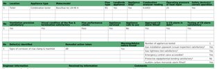

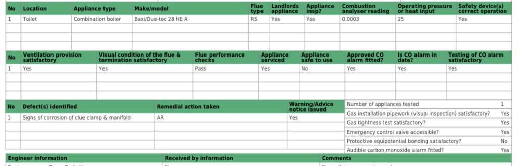

Failed the gas safety inspection, apparently not safe to use:

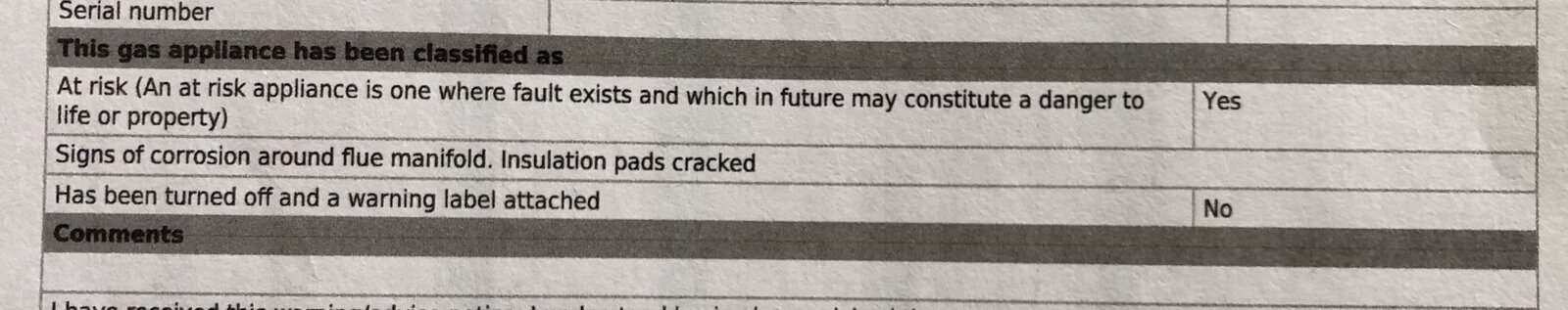

Ok, it's AR so 'At Risk', will leave the Gas Safe Guys to explain the position there as I'm not 100% sure, but as the Landlord, I would have expected the Lettings Agent to have notified you at the very least. At minimum it needs urgent repairs, possibly better off to replace.
And the “warning notice” (received along with a £3k quote to sort from the same in-house gas engineers):
