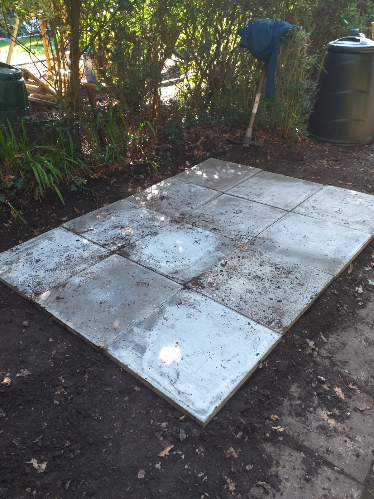

Did I lay this patio correctly?
22 Nov 2018
1,588
26

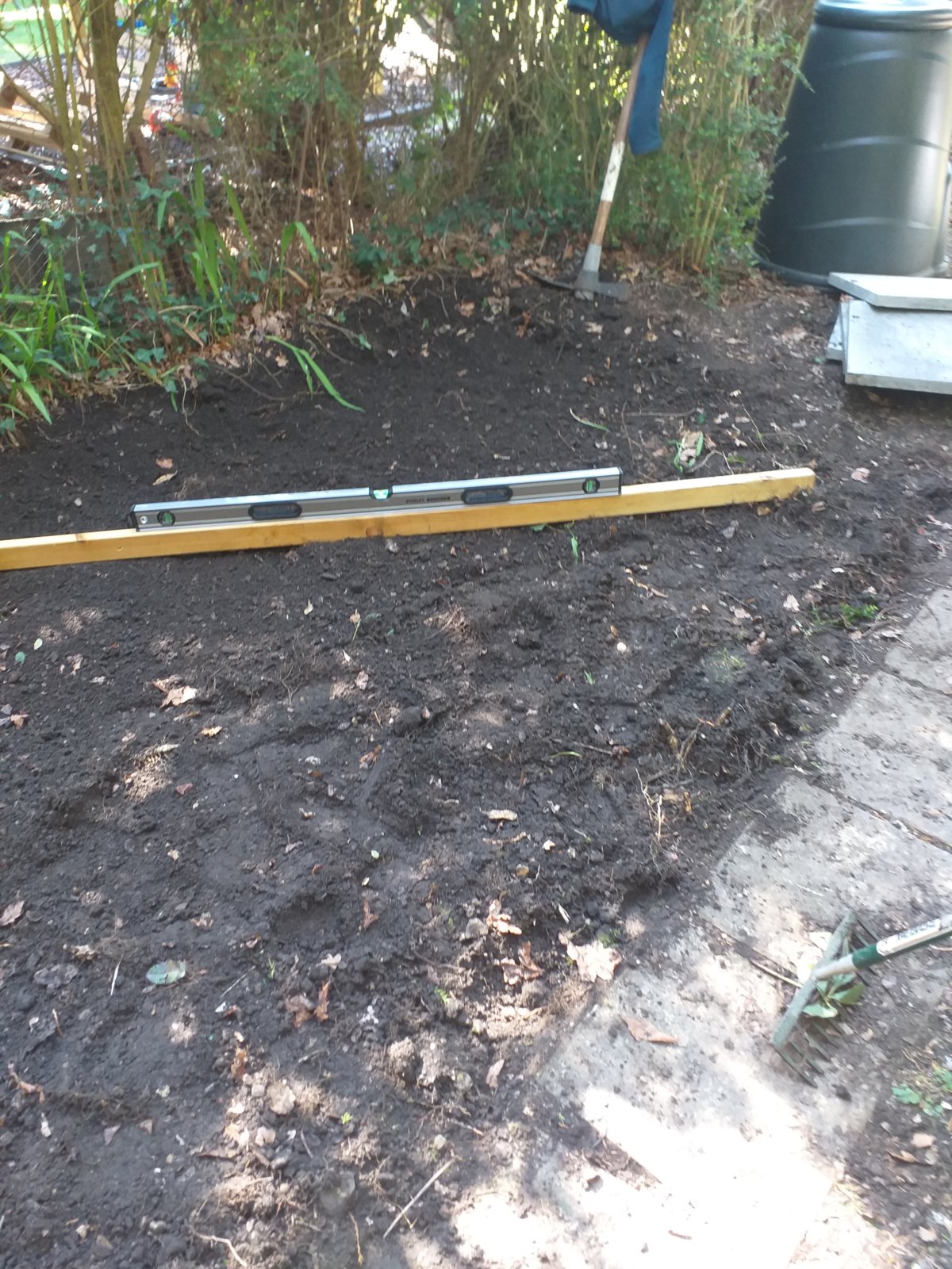

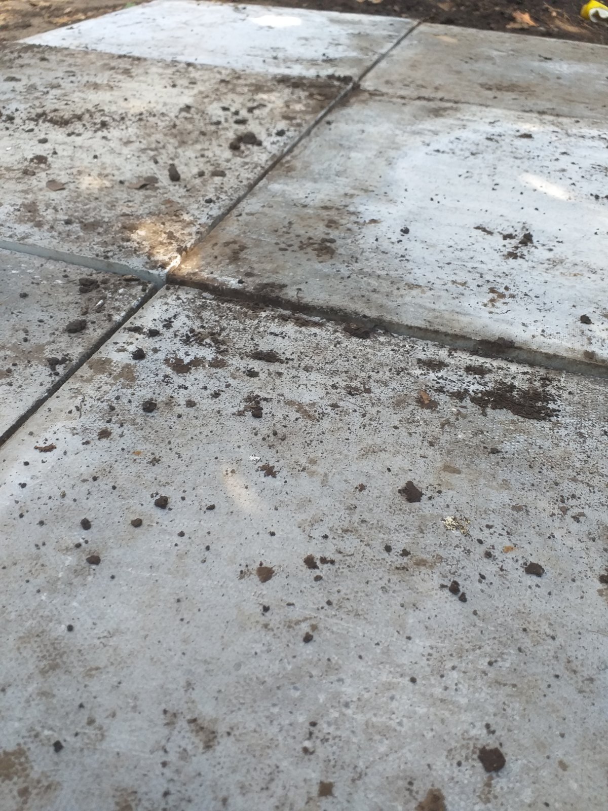

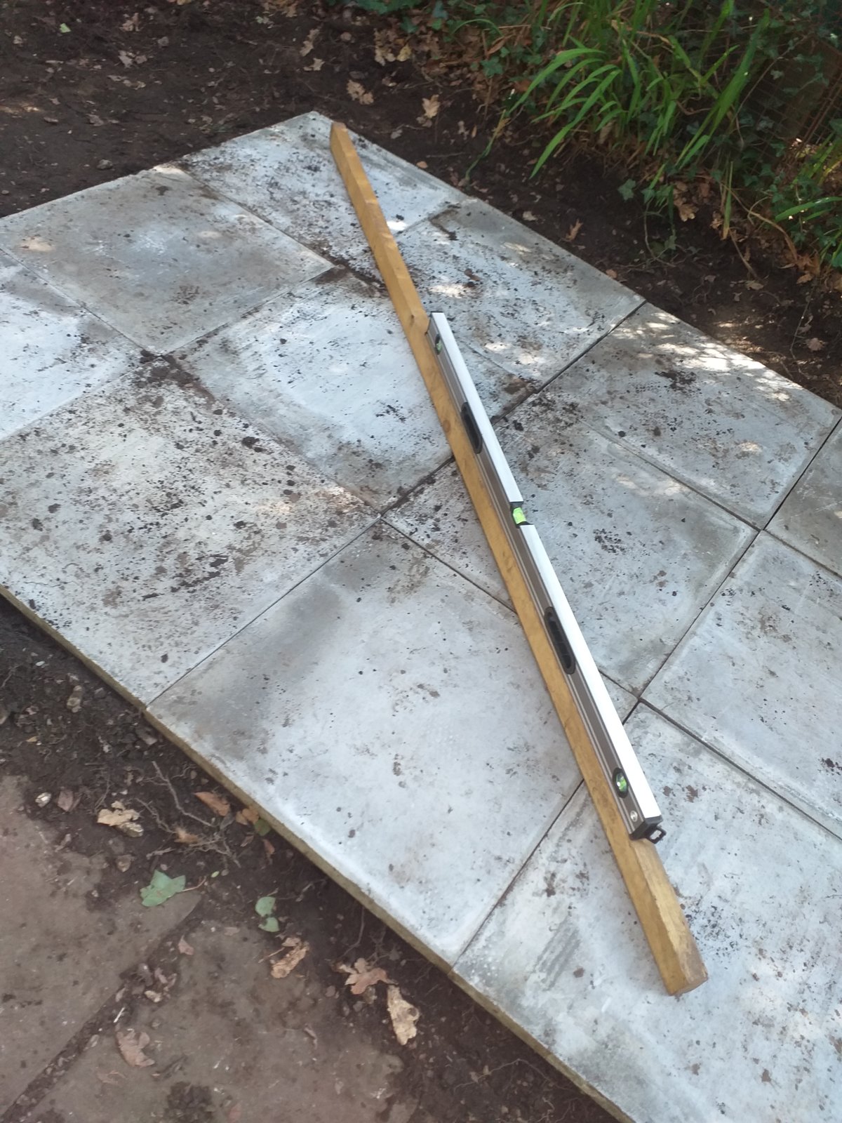

I was putting patio stones not cementing them in onto soil. The ground wasn't level so I rsked back and forth. Dug out the high end and raised the lower end with soil. Put the stones on . Tezted to see if they rocked by standing on the corners then rocking myself. Then if they rocked put some soil under the lower bit. Couldn't get them all level with each other though. Does it matter?
I guess on sand and cement it matters
It’s ok if it’s for your own bins or shed, but if I payed someone to do it id want them straight and solid.

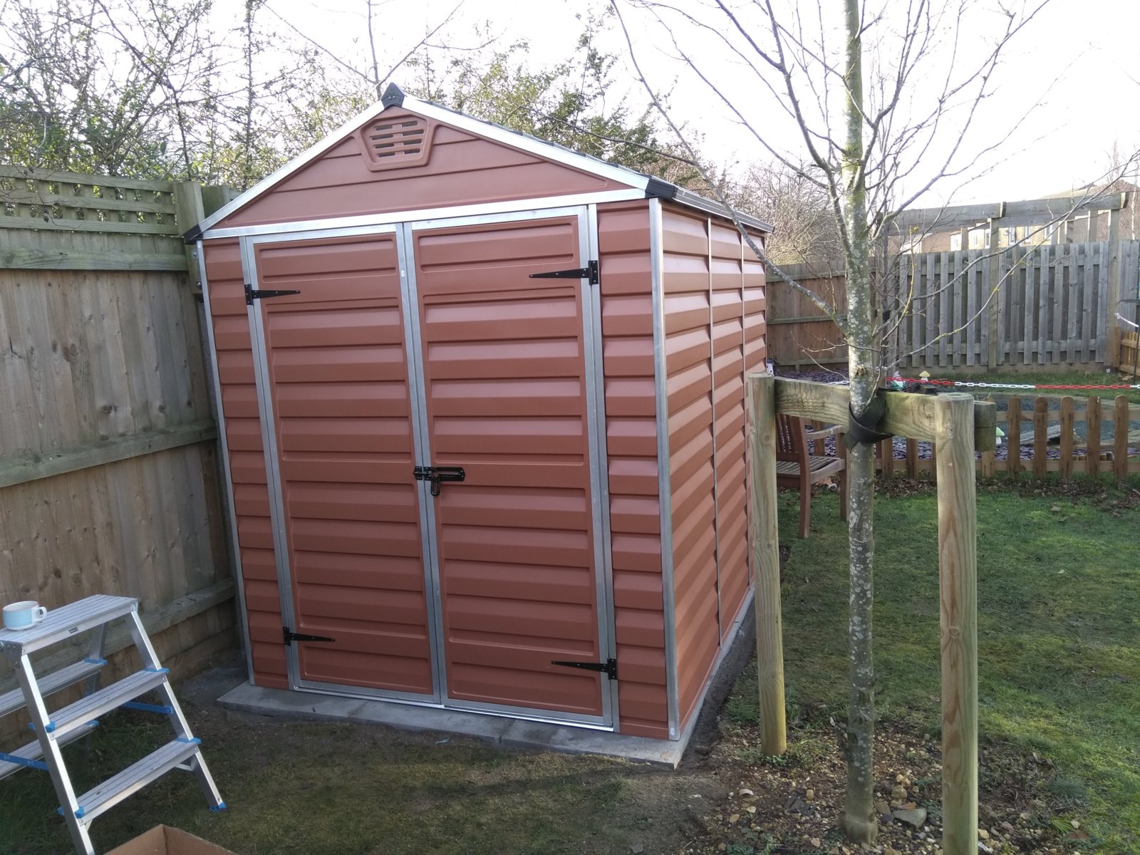

Is it for the plastic shed? It might not be very happy on an uneven base, depends how strong the floor is
Yes it is.
Out of interest, how would you get all the different slabs at the same level? For example if one's a bit higher than the one next to it
You would knock them down onto sand and cement with a rubber mallet.
Probably not, i came across this many times in my professional paving career.
Plastic shed on this will not work if its one of these thati put up at work.
The base needs to be perfect to build it.
So u reckon I should have just levelled soil or hit the slabs down with a rubber mallet like mattylad recommended?
I put my shed on railway sleepers, which sit on 3x2 slabs. I leveled the soil, compressed it the best I could without machinery, laid a dry mix of sand and cement and then laid slabs on top. Took a bit of time getting them level but this was done by moving the dry mix around. Within a few days it was solid and level... two years later it's still solid and level.
I'd prep the ground a bit better by tamping/flattening the soil and laying a dry mix of sand and cement (4:1). Lay slabs then allow ground moisture to harden the mixture.

For your intended use it will be fine. I don't think dot and dob is acceptable on any type of patio really given there are weak spots where the concrete is absent.
I probably put on around ½" thick coating over a 10' x 8' area, although compacting and leveling the ground is just as important. For this intended use there's no need to grout -- I just brushed the dry mix into the small gaps between slabs and lightly sprayed over with hose pipe on mist.
