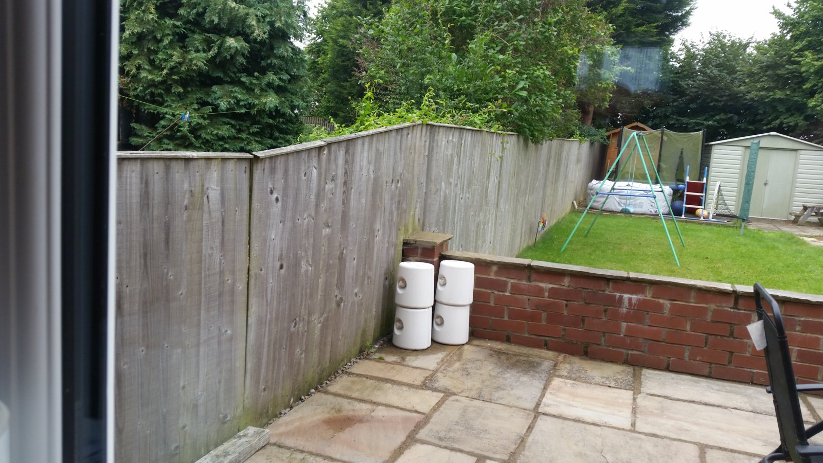

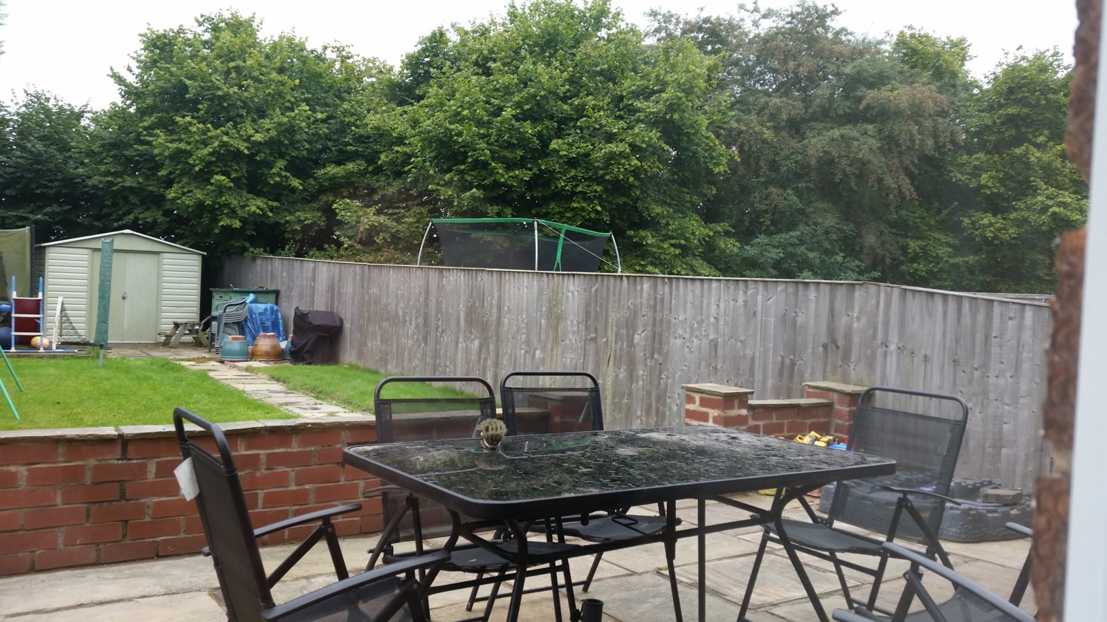

Hello all, I have a fence that's been up 10 years or more it was hand made on site and continuous along both sides and back of my garden.
The problem is the posts have started to go, some parts of the garden got badly waterlogged over winter (a few winters actually!).
Since the fence itself is in good condition I'd like to sink some new posts down on my side to stabilise it again.

Debating wether to try and cut the fence into panels as I go (a lot of work!) or just put new posts down my side for the time being.
Either way it's going to be a ball ache but needs sorting as I doubt it will last another winter!.
I've decided to cut the fence into sections and to make panels out of them, so I can pull panels out later for easier maintenance.
Unfortunately they aren't perfectly placed for 6ft panels but hey ho, just means trimming 6ft panels down if we ever decide to re-fence and the posts are still sound.
