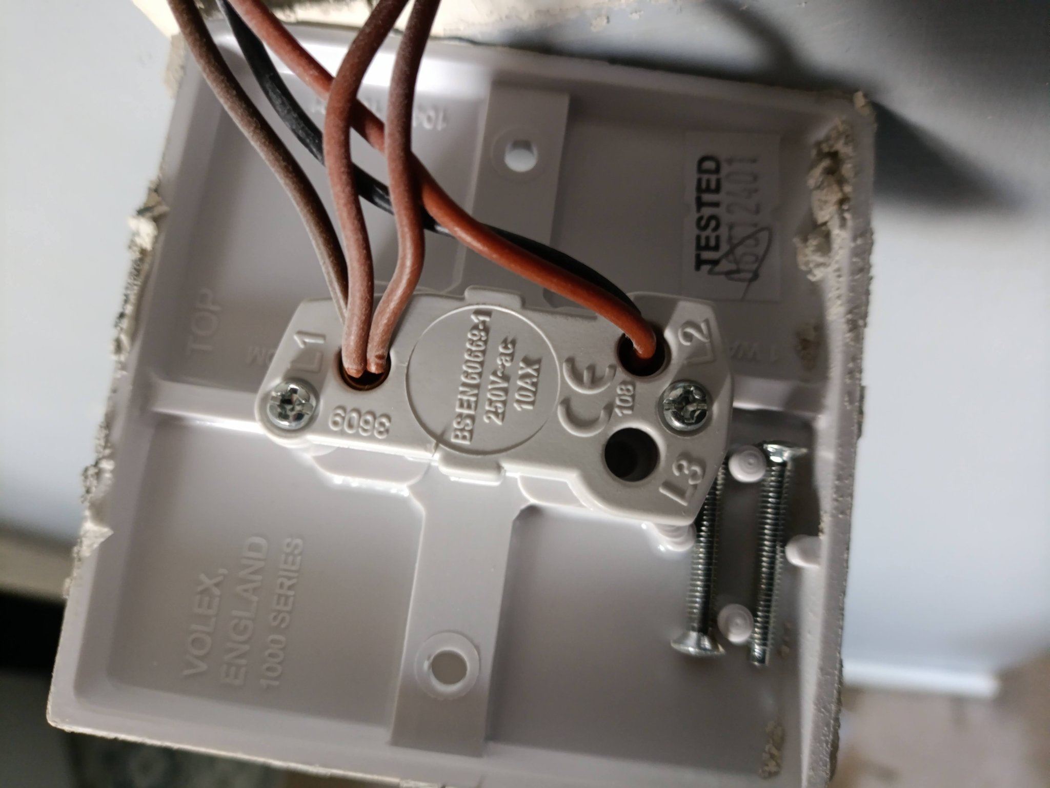

Hi
I am looking to replace my bathroom light switch with a dimmer switch
The bathroom is upstairs has an extractor fan and a shaver socket
I've attached a pic of the current wiring
There are 3 wires in the common and 2 in L2
Can I ask why so many wires? also looking elsewhere online I have read that the L1 on this switch is the common and L2 is taking place of L1
So would I just put all the L1 wires into common on the dimmer switch and the L2 wires into L1?
Thanks in advance
If the extractor is triggered by the light switch you would be ill advised to put it on a dimmer

I think it's a job for an electrician as the fan is wired to same switch
Would have to have 2 switches one for the fan one for the light (dimmable LED)
