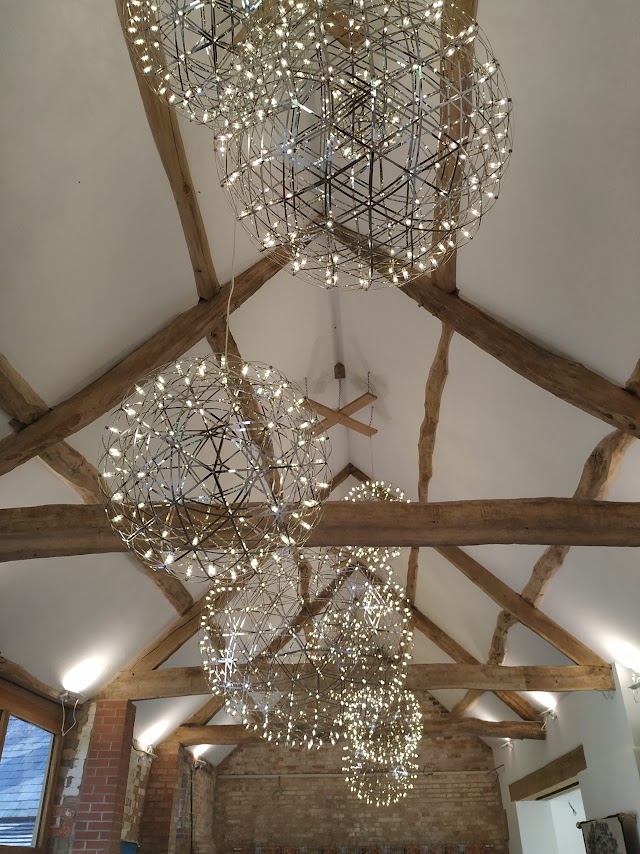

I am looking for 12V G4 LEDs for a large light fixture.
The choice of (current) dimmable LEDs is minimal. However can I dim "non dimmable" G4 LEDs using a constant voltage PWM dimming driver?
This appears to work with a single G4 LED in a test setup but I am concerned about longevity of life (the light fixture is inaccessible).
There will be 36 12V bulbs in parallel if that makes a difference.

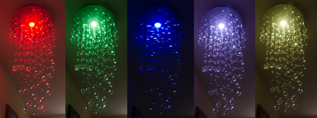

So the traditional way to vary light output is to arrange as 1/3 and 2/3 of bulbs, so three output levels, and today with smart relays it does not need hard wiring, I do the same with GU10 lamps, can select centre, outer, or both. DSC_6799.jpg Centre_bulb_colours.jpg it does not need a dimmer switch with multi-bulbs to adjust light levels, and with extra low voltage you need to have some way to tell the power supply to change output power, my LED strip lights have a power supply, then a controller, and then the strip of lights. It becomes complex, and only real way is buy as a kit so all items are sure to work with each other.
