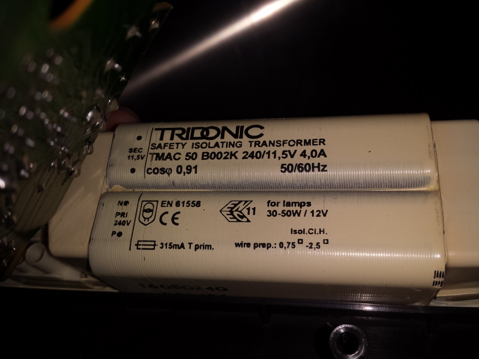

OK, I managed to get to the innards....
So, as far as I can see it is, as suspected, a SMPSU.
If I did go to the bother of replacing it for an LED driver. Is it as simple as a straight swap with something like this?

Interesting.....I was trying to work out how I could identify it as such. I was led to understand that a "true transformer" would feel rather substantial in weight as per @Harry Bloomfield 's post. This did not feel that heavy.
I was trying to decipher if any of the figures on the image relate to the minimum load requite to switch the transformer or something (if it was an SMPSU).

Good to know! The secret (not so secret) symbols!
Which means, in theory I should be able to straight swap some 12v led g4s in.
I assume it is a "they either work or they don't" situation.
Follow-up question, what determines that logo being present. For example, the LED driver also has that symbol. It is to delineate a specific method of stepping down the voltage?
I thought LED drivers operated in a different way from true transformers.
That Tridonic item is a wirewound transformer, and G4 LEDs should work with it.
The only minor problem may be the output voltage being higher than it should be due to the reduced load, but that is easily resolved by using something like these: https://www.amazon.co.uk/Equivalent-Bi-Pin-12V-24V-Lumens-WeiXuan/dp/B0794Z35W9
which work up to 24V.
The existing reflector in the light fitting may need to be removed so that they will fit in.
