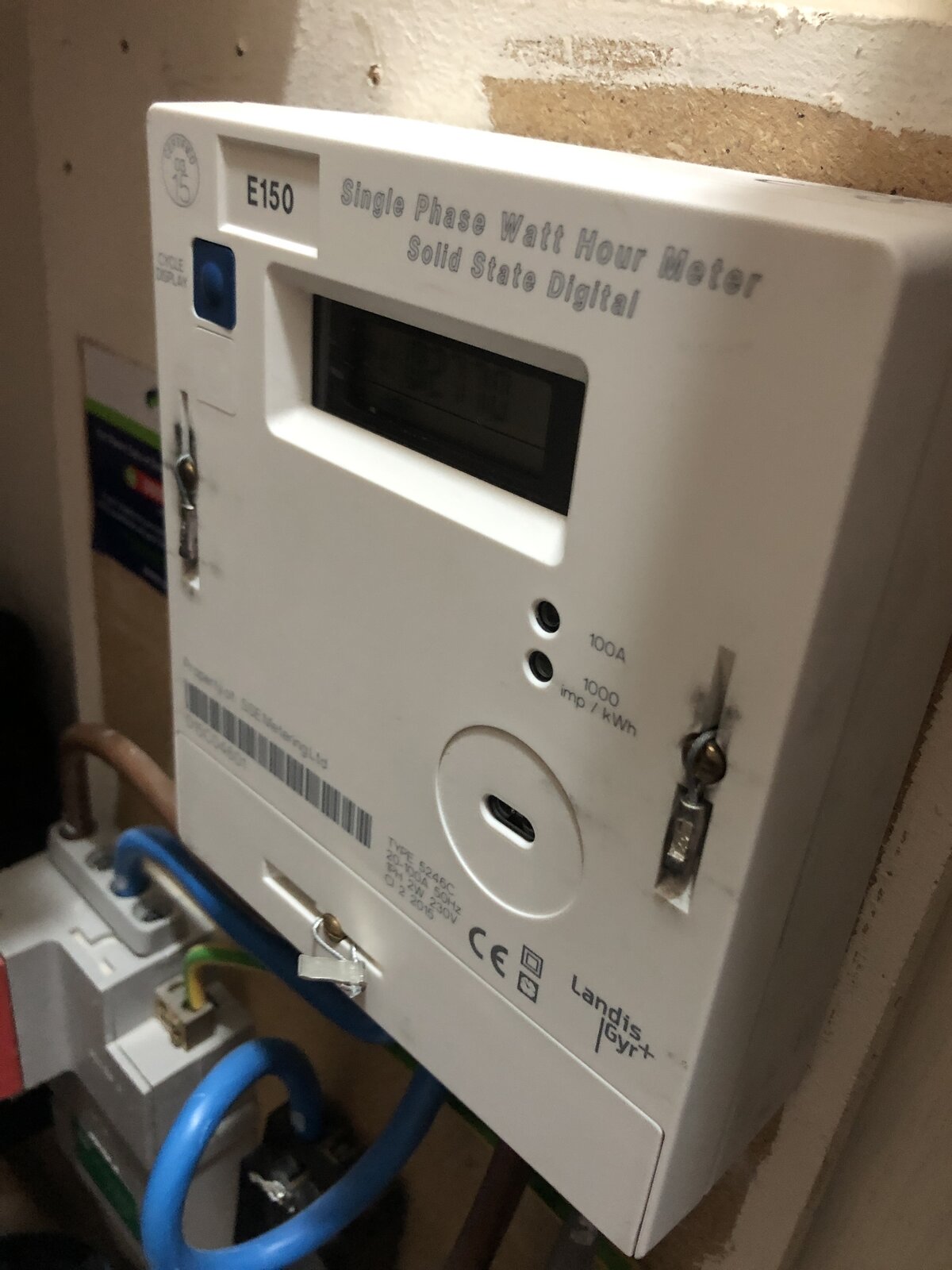

I have just replaced an old Creda storage heater with a new QM150RF. The new heater is wired up to the same supplies that were connected to the Creda, eg one Off Peak supply, and a 24/7 Peak supply (note the Creda also had a built in fan and 1.5kw supplementary heating element so required a 24/7 supply). The 2 feeds into the new heater are from separate spurs. The spur supplying the Off Peak has a neon so I can confirm it comes on and goes off in accordance with when the meter switches over supply. The meter installed (Scottish and Southern) is a new style “white” meter (see photo) which switches between O/P (R2) and Peak (R1) automatically, with O/P becoming available to all circuits in the house, between 23.30 and 07.30. Annoyingly I notice the meter doesn’t adjust for BST, which means in the winter months O/P comes on at 00.30 and goes off at 08.30.
