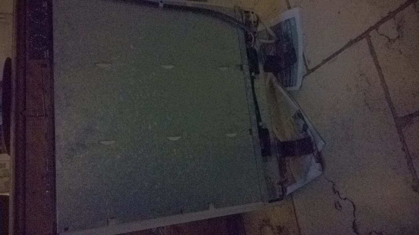

wgt52 I'm looking at the front panel (see pic) and wondered should I be taking this panel off, looking at the cabling on it.
You won’t get to the bricks unless you remove the inner panel.
PS an electric screwdriver is your best friend for this job. There’s a lot of screws.
PPS this may not be the exact installation instructions for your model, but they are more of less all the same
https://www.dimplex.co.uk/sites/def..._XLSN_Installation_Instructions_Issue_013.pdf
