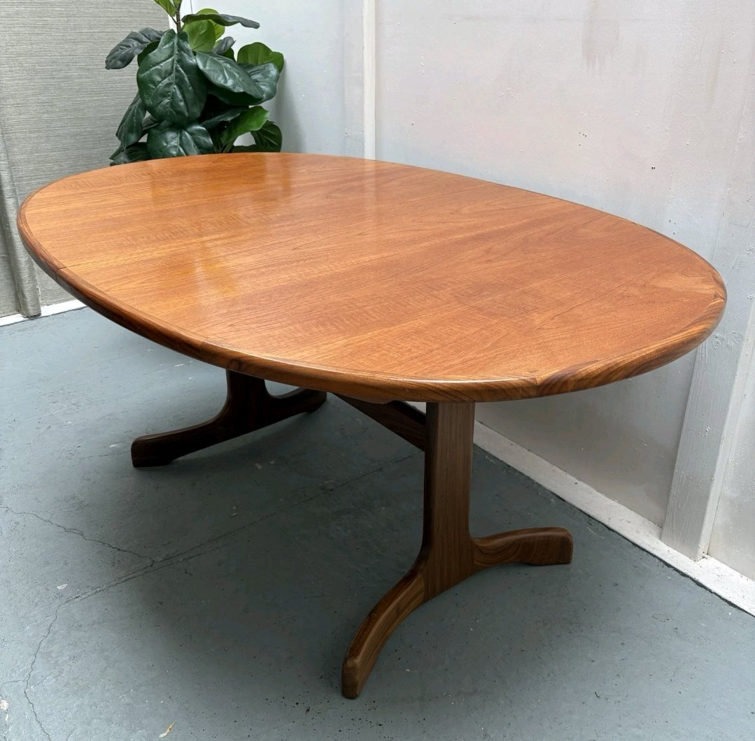

Hi,

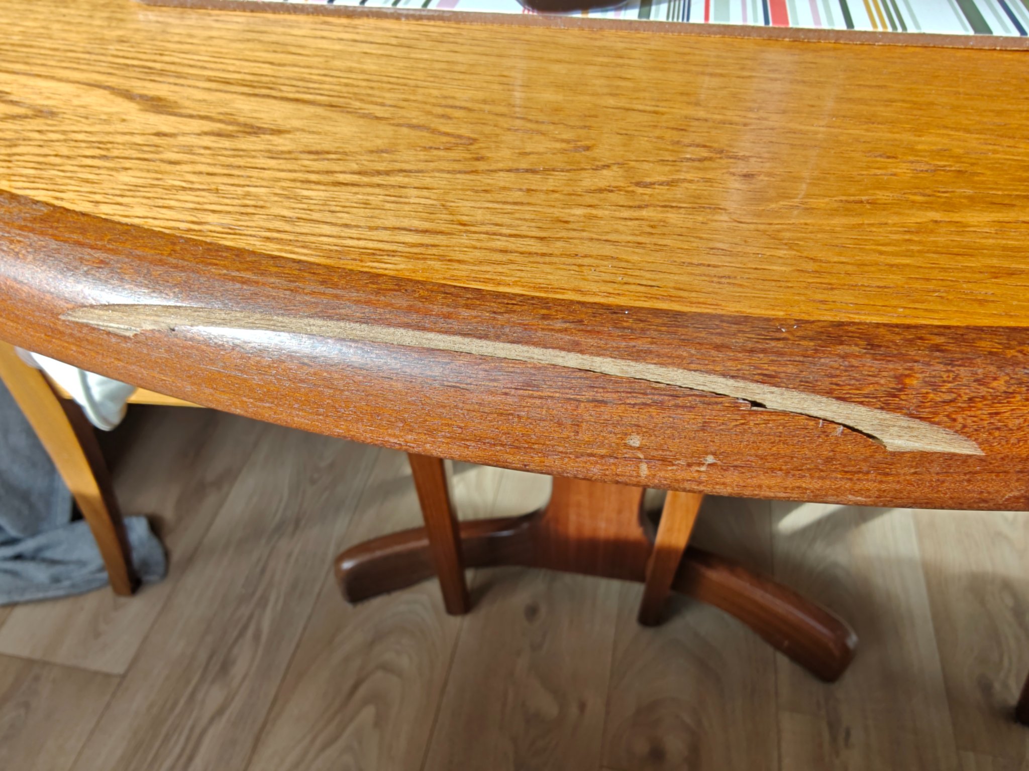

Last weekend while cutting down a door, I stupidly cut through our dining room table (I know I'm an idiot). It's a Gplan Fresco dining table like the first pic, I believe it is made from teak and afromosia wood.
Does anyone have any advice on how to repair? I know it won't be perfect again and will live with the forever reminder of my stupidity.
Thanks for any advice.

Hum..
This is more filling and french polishing so a bit technical
There are courses you can go on.
I don't think you will buy anything off the shelf and fill that easily.
Might have to live with it and the day to day grief
general comments
as its a curve you will never get any better than "ouch" you can iff you can get a bit off stained similar grained [perhaps oak or iroko ] toned a tiny bit darker making it less obvious than the light oak centre but no better than that without an expert with "graining " ability
random link
Is the wood underneath a veneer you can rob to repair the surface?
whilst in normal situations this is the best and correct answer
in my opinion this is solid steam bent timber on the edge so not only no veneer to be harvested you also have a compound curve where the grain will be compressed as at an angle also a straight grain across a curve so nothing can be hidden just visually reduced from wtf to in your face unless extreme disguise through colour and grain manipulation involved
