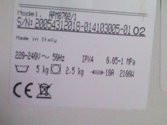

Ok, so there are two labels under the door, as follows:
1st...
Model: APM8702/1
S/N: 20054312018-014103005-01 02
Made in Italy
2nd...
This appliance uses different parts to the APM 8702, please order parts:
Motor 512011600
Electronic Module 546060200
Wiring 552019200
Cabinet 710062501
Suspension spring for tub 444011700
Drive Belt 416002800
464249090
Mmmh. Non-standard parts usually means 'more expensive', doesn't it? Just my luck...

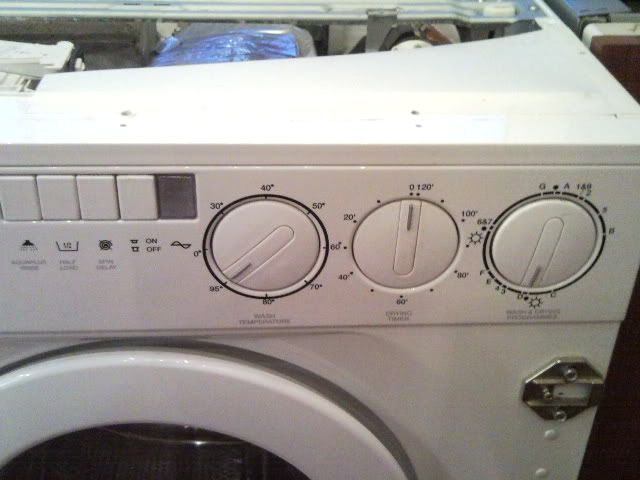

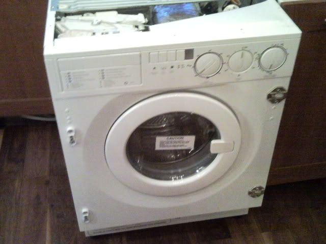

Wow...this thing isn't easy to identify, how old is it? I might be sticking my neck out but I have a feeling it is one of an oddball series "Zanussi type" machines produced in Porcia Italy. Judging by the door labels it looks like it might have been knocked together using a bunch of old spare parts they had lying around in the garage!
Do the sides have what looks like a "seam" in the middle? Can you post a photo of the beast? (especially one of the control panel).
Wasn't too sure how to post pictures on the forum so hope this works...
Thanks for all your help so far!
D

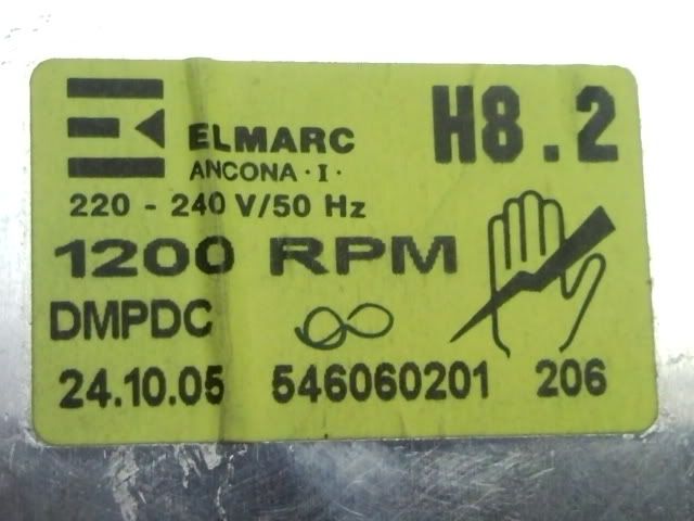

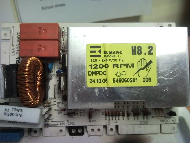

Do you suspect the electronic module or was that just a general link for parts?
D
