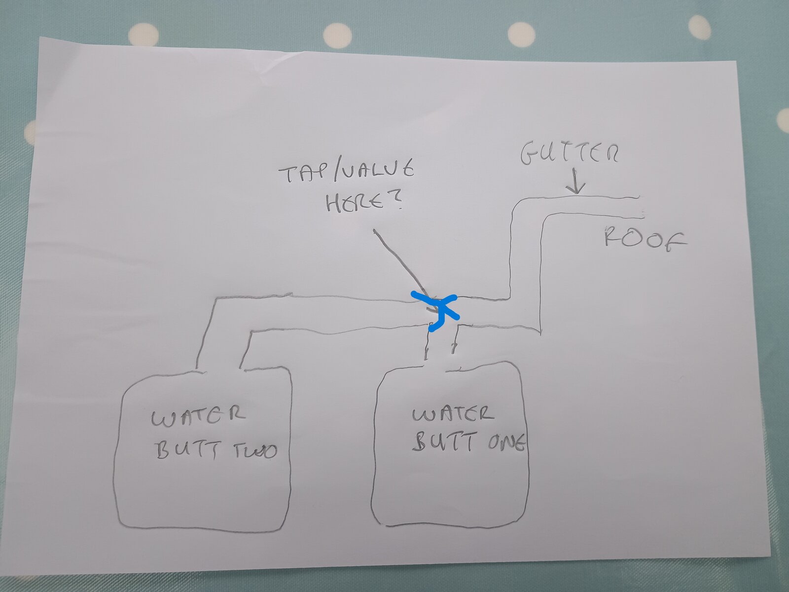

Hi
Apologies if this is posted on the wrong channel. Apologies also if this seems very basic – I am a DIY newcomer.
I’ve a question about getting water from my guttering into more than one water butt. I’ve attached a diagram which might help with the explanation.
I have a garage with a sloped roof and this has guttering which flows into the water butt labelled “Water Butt One” in the diagram.
At the moment the piping stops at the point marked X. I want to extend it so it goes into a second water butt, as shown in the diagram. I’m thinking I need a tap/value at the ‘X’ so I can direct the water in the second water butt once the first is full.
First question – is it possible to buy a tap/valve along these lines. I’ve had a quick search online, but couldn’t find anything.
Second – is this best way of solving my problem? Grateful for suggestions for alternatives.
Thanks in advance for your help.
Chris
This is one example of commercially available devices to do what you wish
That system diverts the downpipe flow and when the butts are full passes water into the remaining downpipe / soakaway system rather than just overflowing from the butt onto the nearby ground.

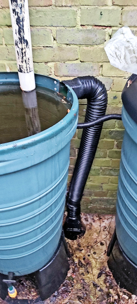

In my experience these diverter kits block up very quickly and dump most of the water down the drain anyway. What you could do is leave the drain pipe into tank one as per your pic and use a linking kit as suggested above. You will also need to provide an overflow to the drain from tank 1 the same size or larger than the inlet pipe. You will also occasionally need to clean the crud out of tank 1 maybe once per season.
...and it's a good idea to cut the lid to fit round the pipe, so that you don't get cats or birds drowning, or mosquitos thriving.
If the buts are at the same level, If you simply connect a pipe between the buts (ideally at the bottom of them) then they will stay at the same water level as each other.
I prefer to link at the top, so all but the last will be full (until you drain them), giving a good flow to fill your watering can or hose.
