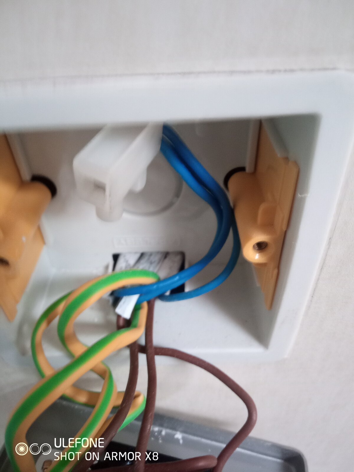

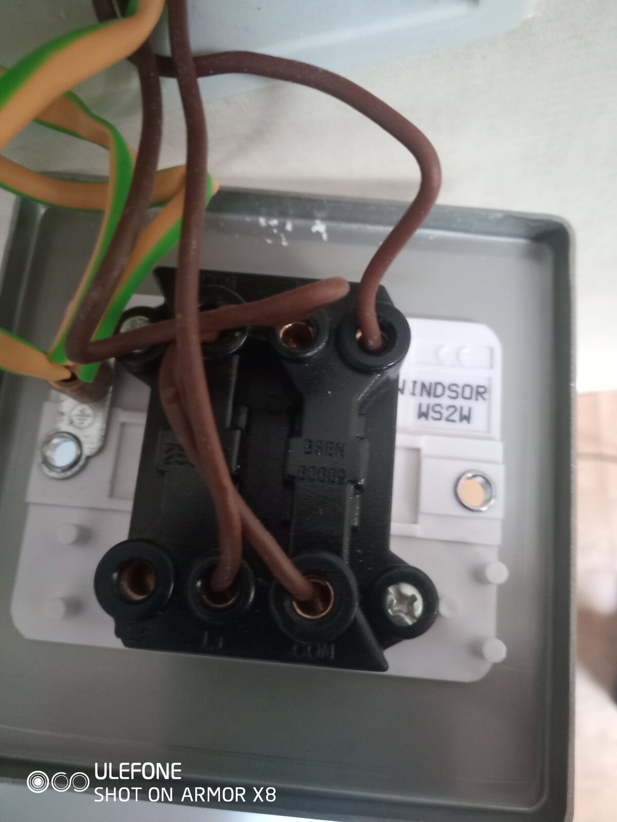

Hi. I have taken low voltage cabinet lights out and a switch isolator . The double switch needs disabling and the wires terminal blocking so I can take the switch off the wall . Below are the pictures . Anyone any advice please ?

What do you intend to do after removing the switch ,are you going to fit a blanking plate in its place ?
Yes. That's what I want to do , cheers
It sounds lk you have worked it out for yourself already.
Turn power off, check for dead to make sure you dont get a shock, slacken switch screws & remove switch, insert all 3 brown wires into individual bits of terminal block and tighten screws ensuring nothing can touch live parts, turn power back on.
Put the earth conductors together in an insulated terminal block.
Put the 3 brown ones into 3 seperate insulated terminal blocks,and leave the blues as they are.
