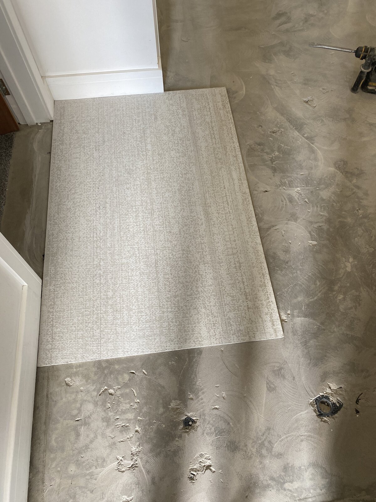

looking for advice on how to get around a disaster of a levelling job.

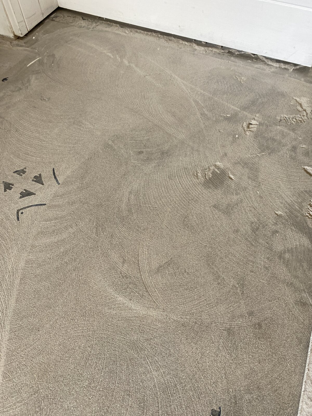

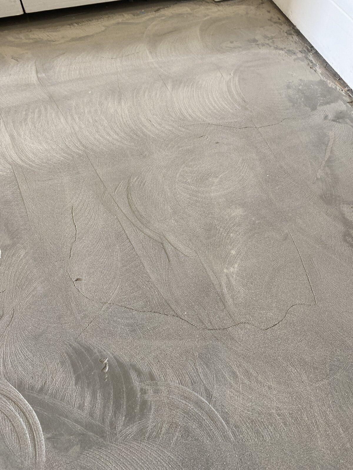

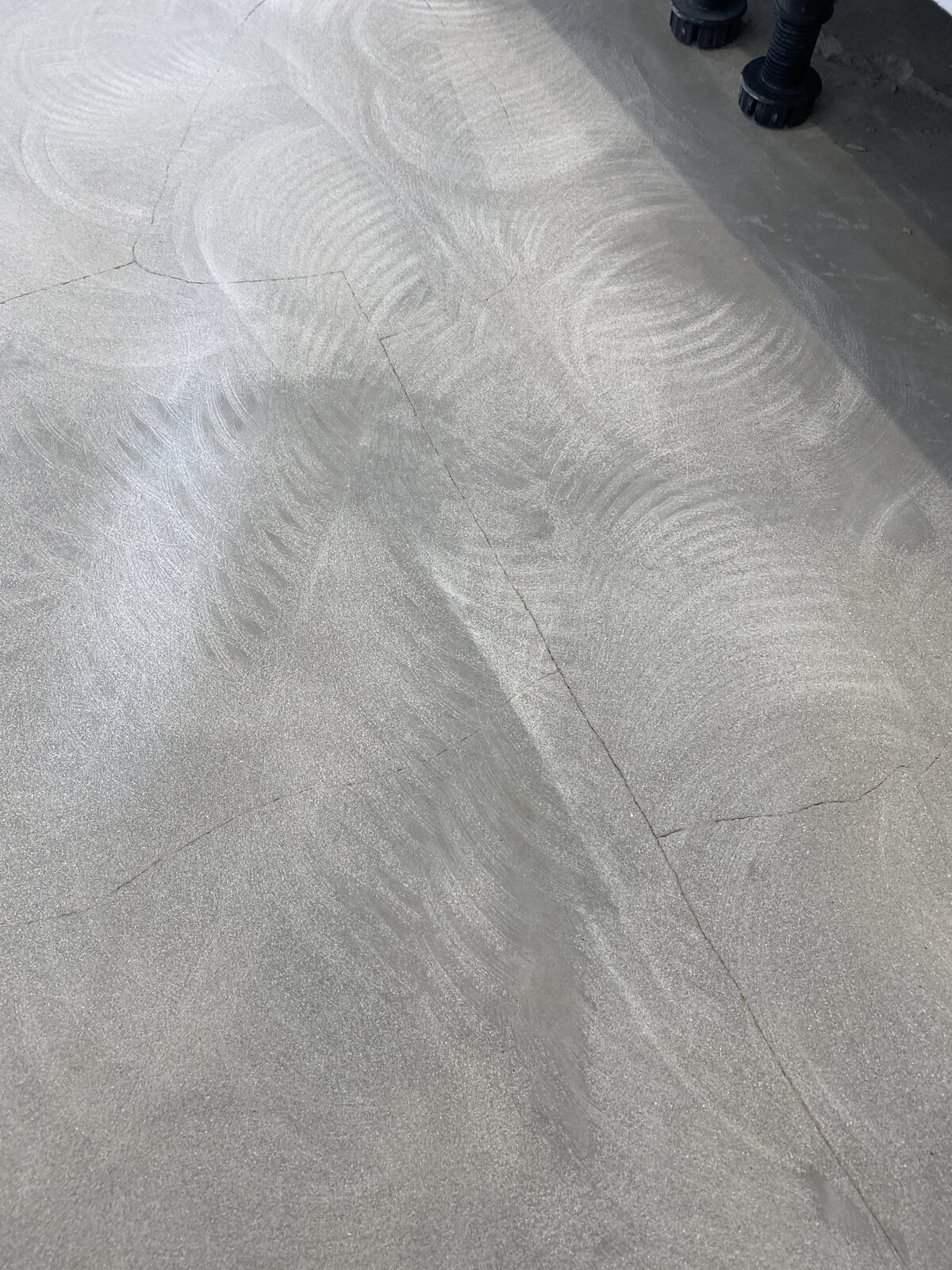

Basically we have cracked and slightly hollow sounding levelling compound in a low profile underfloor heating floor. It’s mostly solid as it’s bonded to the castellated panels, but areas sound hollow in places. I’ve ground the top layer off to give me some depth to play with, can’t go too far as I’ll hit the pipes.
I’m trying to avoid ripping it all out, pipework, panels etc as it would be a nightmare replacing it all.
Have thought of two options but looking for advice on whether either would likely work.
First is 4mm hardiebacker laid on top, presumable with some kind of flexible tile adhesive?
Second is to use a re-enforcement mat in/over/under the top and pour another levelling (Mapei 3240 or similar as it’s reenforced and flexible) over the top?
not sure if either of these would work or if anyone has any better ideas?
was hoping to LVT over the top
Any help much appreciated !
cheers!

Levels aren’t an issue. the kitchen is new and has been installed with the raising of the floor taken into account for the plinths etc, but half of it isn’t installed anyway, as we wanted to get the floor done before installing end panels etc so plenty of scope to adjust as required.
basically, the floor issue was only noticed when the kitchen went in, as we had a temporary floor down over it all which was removed during the install of the kitchen and revealed all the problems. By that point we had a dining room full of new kitchen so we cracked on as best we could.
The more I look into the floor the more I realise how bad it may be, hence grinding back as much as poss to start over.
it’s a 1970s and I believe it may have had Marley floor tiles which, since reading on here after posting, I now realise this may have been the DPC?
if so, could this be part of the cause of the cracking?
Also, might be worth mentioning, the compound I was supplied wasn’t what I was expecting from the supplier (during lockdown, supply issues) and stunk of egg for weeks and weeks after laying. Could this indicate a bad batch?
As per the title, bit of a disaster!
cheers!
P.S - sorry, I didn’t answer some of your other points.
the levelling is up to 18mm deep but variable as the castellated panels vary in height in places. They also have holes in them so the compound flows into certain parts of the panel, presumably to interlock it all together. Certainly seems to have worked as it’s generally solid, just hollow when tapping under some of the bigger gaps.
was +3mm over the top of the panel, I’ve probably ground 2mm of that back.
Cheers!

I pulled out the thermal imaging camera today and can trace the pipework so I could possibly break out the hollow spots, but the cracking is pretty much all over, even though not all hollow sounding, and some of it is where the pipework is, so too risky to try chiselling out.
