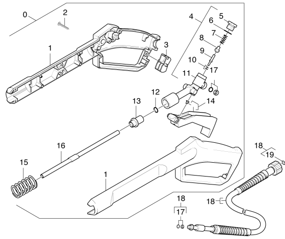

Afternoon,
Any ideas on how to disconnect the hose from the lance?
I’m pressing the button and twisting the hose but it won’t pull out.
Ta.

Ok I think I’ve figured it out. Looks like there’s a safety feature so you can’t disconnect any parts until the pressure is released.
This is not explained in the manual…..
I needed to do the following once I’d finished using the washer:
1. Turn the washer off.
2. Press the trigger (to release the water pressure) then simultaneously press the hose release button.
3. Remove the hose from the lance.
4. Turn off water supply.
Once this process has been done you can remove the hose at will by just pressing the hose release button.
