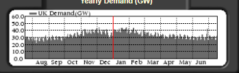

Demand at the moment is 36GW. Sometimes it may go over 40GW in the winter.
Your 50% more looks optimistic.
You can't say 155GW per day.
Is that total electricity demand across the UK ?
That goes well over 50GW peaks in winter, and can reach 60GW during those midwinter widespread anticyclones - like that in Dec 2010 - when both wind and solar PV are doing essentially f**k-all for several weeks.
It was at the time - 32.5GW now.
http://www.gridwatch.templar.co.uk/
I was going by the yearly graph. I don't know what happened in 2010.
