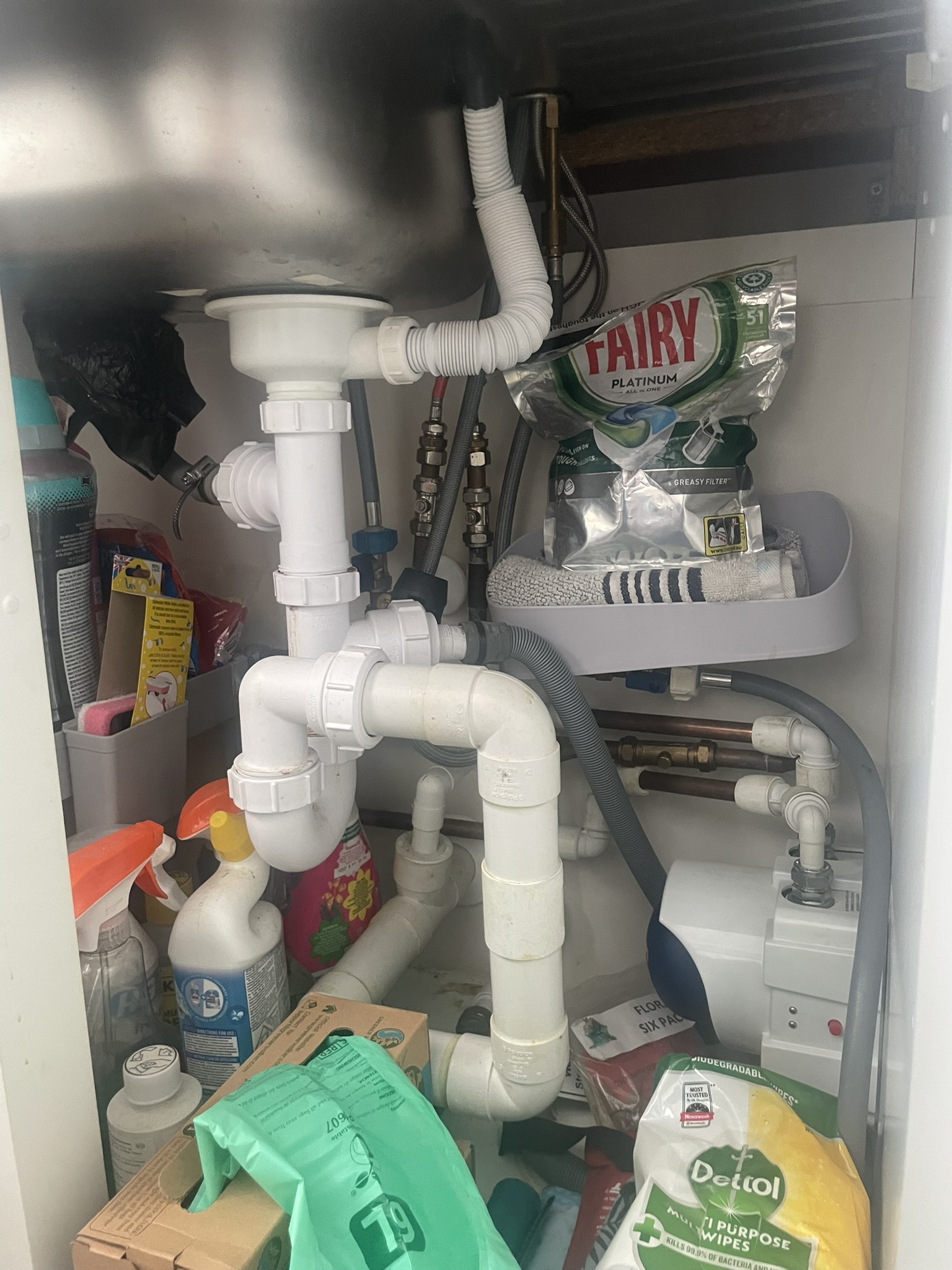

If you show us photos of your waste pipes and the hoses from the appliances, we will probably spot the error. You must show the height of all of them relative to the floor and the worktop.
The reason for the high loop in the hoses, going up to the underside of the worktop, is so that water cannot run downhill into the hose from the sink or other appliance.
If you have a pump pushing out water from an appliance, it must be able to run downhill into the waste faster than it is being pumped.

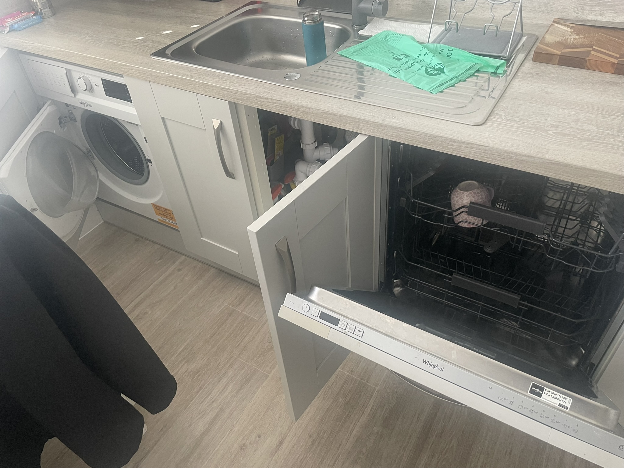

All the units are 'built-in' however... so im not sure if i can easily access without pulling out units (in which case i may as well get an expert to take a look).

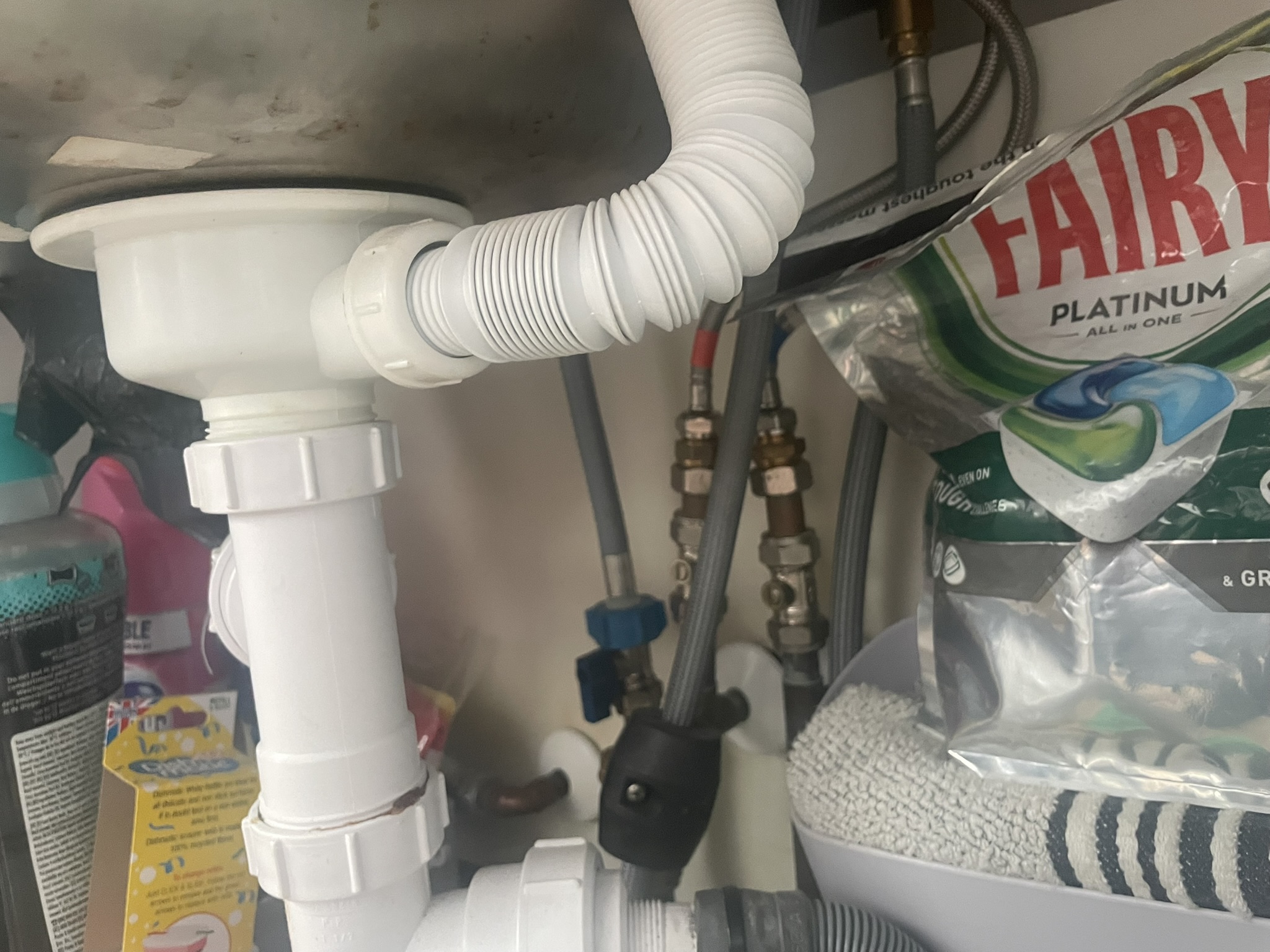

Photos below the sink, showing the connection to the sink waste is fine.
