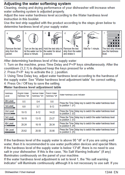

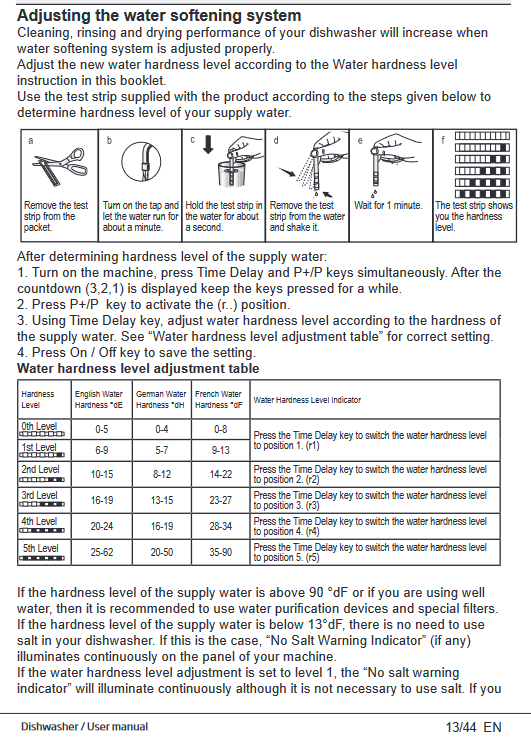

I seem to remember when we got our dish washer new, there was some thing which tested the water and we had to set the dose based on the results, I have never re-tested, but unless it is tested the dose is clearly a bit hit and miss. I looked at the instructions 1707124554286.png and it tests water out of the tap not water after the dish washing tablet has been dispensed. So it would be impossible to calibrate allowing for the stuff in the tablet, and clearly tablets would need to be designed for your area, not read the dish washer tablet box, but do not remember seeing any reference as to if for hard or soft water areas.
So I would select a half way approach, and set the dose lower than the chart says, however reading the instructions it does refer to having the combined tablets, it says "These tablets show their effects up to a certain water hardness level (21°dH)." so reading the instructions it does tell one at what point to use salt when combined with the tablet.
