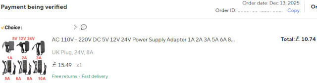

I am in for more luck. I fixed the apple monitor using sellotape. The dishwasher severely wounded the circuitry for tuning on the monitor power supply. Masking out the circuitry allowed the power supply to work again. That saved me a tenner buying a china psu.

Piece of junk apple monitor PSU was poor quality. I will replace it with a cheap china one. The other interfered USB hub was on a HP business grade monitor. Since no permanent damage was done, I suppose the quality on that was slightly better. My PC uses a china PSU. Nothing on it was affected by the dirty electricity. Although, during diagnoses through process of elimination, I bought replacement china PC PSU and PC motherboard. Now I have a redundant set of the good stuff and will be secure for a very long time.
The new monitor PSU will be off-spec by -0.5v for a cost of £13.5 compared to £55 for a non-new apple one. The HP monitor could be used as a noise detector. I will know there is line noise if the USB goes and my mouse stops working.
