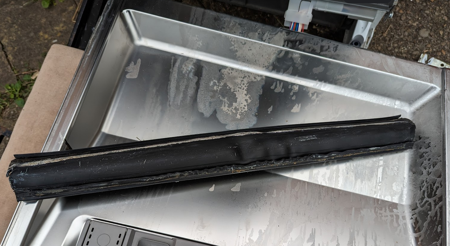

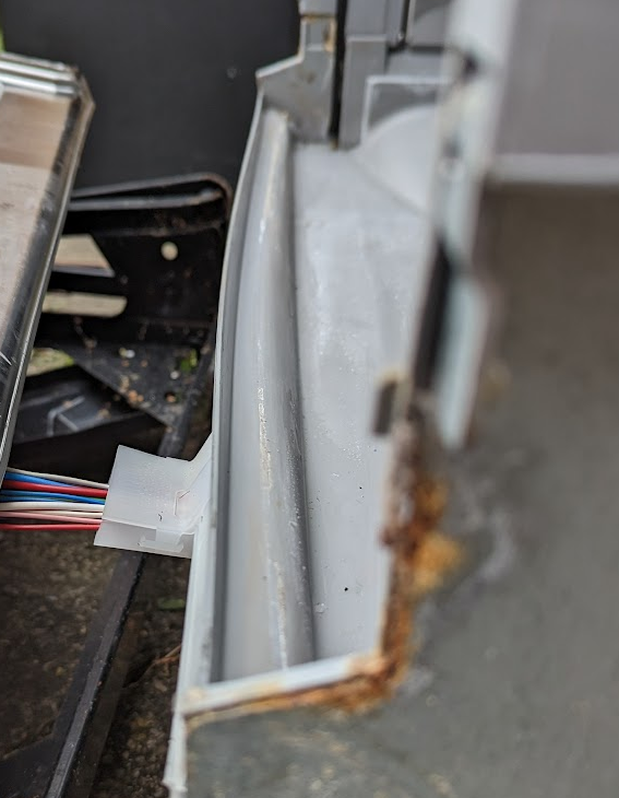

My dishwasher is a pretty old model, Bosch SGS43T72GB/16 from around 2009. It's leaking seemingly from the bottom seal (although I can't be sure), so I decided to pull it out and have a look. The old seal is in a pretty bad state, but it seems they do the replacement for about £15 so I thought I'll give it a go.
Then I noticed that the bottom of the chamber is curved. Could that be the reason for the leak? Or is it normal? I'm just trying to figure out if it's time to buy a new dishwasher!
