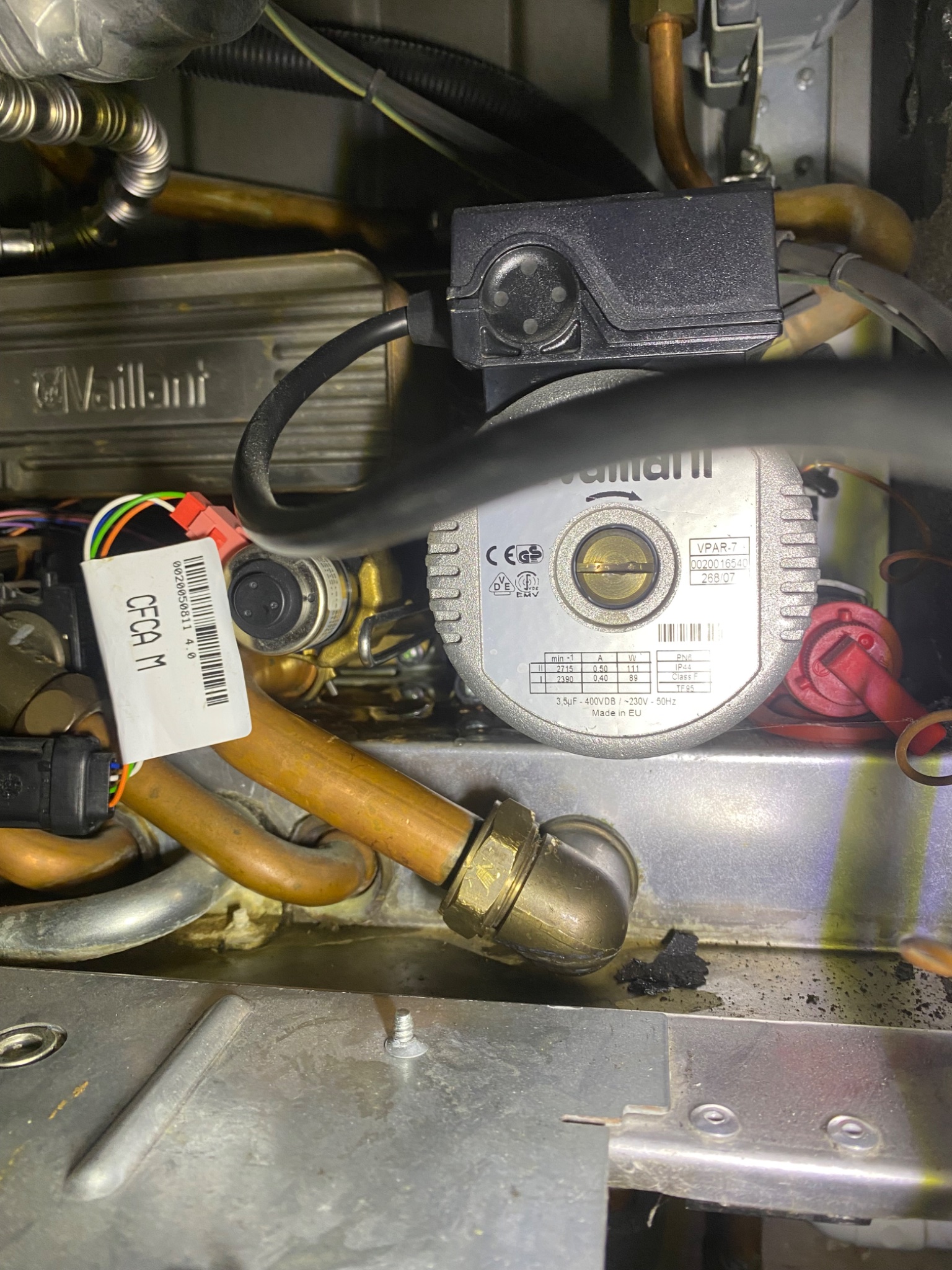

My vaillant combi has a leak and I have just spotted where it is dripping from. The drip is on the brass body of the diverter valve.
Not sure why this should be leaking again as a new valve was fitted in January 2025, so just over a year ago.
Any idea why it might fail again?
The boiler is 16 yr old and has had one diverter valve before the last change in jan 25.
I will add a photo but I don’t think you can see the drip
Did they replace the complete valve with body or just refurbish it with seals.
It was a proper vaillant unit with the full brass body replaced.
My system is clean and has a magna pro 2 filter on it.
Boiler is 18 yo so I think I am now just going to replace
the diverter was changed a year ago and now it is leaking. its 18 yo and I have a constant pressure drop on the boiler which I cannot solve. Been going on for over 2 yrs. I cannot find any leak on the system. Every 2/3 weeks I need to top up half a bar generally. I swapped out the expansion vessel and AAV over a year ago in case these were the issue. Still no change.
The diverter a year ago was the fully brass body made by valiant. When the diverter went last time I thought about just swapping the boiler but decided to try a new diverter. prob wrong decision. My system is clean and I did the filter the other day. It had a bit of magnetite on the magnet, but nothing excessive.
I decided to try a new DV. The one in place cannot come out due to a stiff screw. This was the case a year and a bit ago when the engineer swapped the DV then. One screw was super tight. So it looks like he got it back in but the DV is not happy and maybe is slightly out of alignment.
Anyway, I have a new boiler booked for this Friday. However, I did swap the power lead on the motor for the DV for the new one and now the boiler will not work. So swapped it back to the original one and still the boiler is dead. So we are without any water until Friday. It's not a biggie, but just wanted to know why swapping out one of these connectors should short the board?
