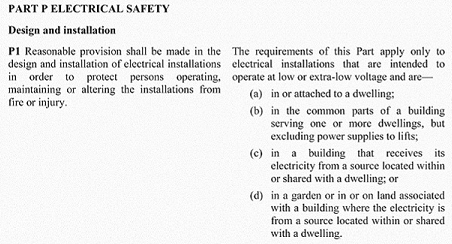

Hey all,
Used this forum for many years and this is the first time I've been unable to find an existing thread with an answer so finally made an account to post myself.
Summary
I'd like to know if tidying up the wiring inside a consumer unit is considered notifiable. As per Part P, I know that all the following is notifiable:
(a) installation of new circuit
(b) replacement of CU
(c) addition/alteration in special location
And it clarifies that the following is non-notifiable:
addition/alteration to existing installations outside of special locations, and replacements, repairs and maintenance anywhere.
I know everything needs to comply with BS 7671 for installation and testing, notifiable or not. But, from my understanding, a simple cable tidy up inside an existing CU (would involve some re-terminating and possibly some wagoboxes if things need extending) and making sure the circuits are all marked/labelled properly would not be notifiable work? Or is that possibly dancing the line a little as far as building control goes?

Firstly, I should like to say that you seem a very intelligent person and as such are as qualified as anyone else to work out what the regulations mean.
They are generally quite poorly written.
(a)the installation of a new circuit;
(b)the replacement of a consumer unit; or
(c)any addition or alteration to existing circuits in a special location.
Does any of that say tidying up the wiring?
After reading (c) why would anyone think it worth writing that?
Although they seem to have overlooked the replacement of consumer units which is notifiable.
I take it you are reading Approved Document P (guidance); not Part P of The Building Regulations (Law) which merely states:
and Regulation 12 which contains the notifiable work.
Approved Document P (and the other letters) is merely a pointless guidance book someone decide to write about the much shorter actual regulations.
No, of course it is not notifiable.

Another way of looking at it is this:
If you tidied up the CU then subsequently sold the house, would the survey pick up any notifiable electrical work which has no accompanying certificate? A = no.
So the only arbiter of compliance is your conscience

I'm glad my interpretation of the regs was correct in regards to if the work is notifiable. I wanted to be extra sure as I couldn't find any example cases anywhere stating as such.
Indeed.In fact,although it might not be easy to find,it's a topic which has frequently been discussed in this forum.
In England (Wales very different), the situation is very straightforward since, as has been said, only three things remain notifiable - but even the wording of those three things has not been thought through properly.
For example, as regards CU, only replacement of a CU is notifiable - so, in the eyes of the law, installation of an additional CU would presumably not be notifiable. Furthermore, although some would undoubtedly argue about this, having installed an additional CU, I personally do'tr see why one could then not transfer all of the existing circuits from the 'old' CU to the 'additional one'. Some would argue that they then became 'new circuits' (hence notifiable) but I don't personally see that - if one goes by the BS7671 definition of 'a circuit', it excludes the OPD (MCB or RCBO) - so, if nothing else about the circuit has changed, I don't see why/how it would/could qualify as a 'new circuit'. One small complication is that the Building Regs do not define 'circuit' (let alone 'new circuit') so I don't see what one can do other than rely on the BS7671 definition!
Again, looks like my initial assumption would be correct here in that a simple swap of the MCB with an RCBO of equal rating should be perfectly fine. It does look like this specific question has actually been answered on these forums before but I threw this one in there before checking so apologies for that.
Indeed, it follows from what I've written above that changing MCBs or RCBOs should not be notifiable, since it constitutes neither 'replacing a CU' or 'installing a new circuit', and certainly is not in a 'special location'.
Kind Regards, John
