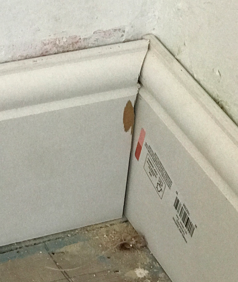

I attempted my first coped corner and turned into a dogs dinner...
I thought I did well with the coping part:
But tried to do the straight cut on the face using my coping saw. Rookie!
Is there anyway I can use my Makita MLS 100 to do this straight cut without it interfering with the coped part? ordinarily, you'd stand the skirting upright bit I am unable to do this with the tall skirting.
I'd appreciate your advice as I plan to improve this with a further attempt:
Start by making a 45° mitre cut across the piece to be scribed with your mitre saw
Enhance the visibility of the edge by rubbing the side of a pencil lead along the angle where the mitre face and the main face intersect. This will make your cut line far more obvious
Using a jig saw or a hand saw, saw away the waste at the bottom of the skirting (the straight bit). You need to angle the saw to give you about 5° of relief (back) angle. You will need to do this for the entire joint, including the bit at the top. This back relief allows you to accommodate out of square corners. Cut from front face towards the back to give a nice sharp edge
Lay the material flat and overhanging the support (bench, table, etc) with the face uppermost.
Set up your coping saw so that the teeth point towards the handle (like a fret saw), not away from it (like a hand saw). This means that you saw by cutting towards the handle (a pull cut). Doing this means the blade is in tension whilst cutting and therefore straighter during the cut than trying to saw the other way, like a normal hand saw
Saw the last piece out (where the Torus moulding is) using the coping saw from below (i.e. the handle is at the back of the material) making a pull cut. Remember that except at the very top of the cut you need to add about 5° back relief angle. The top needs to be more or less square as it will be visible
If needs be wrap some sandpaper around a piece of dowel or the like to clean-up the back of the Torus "bulge". Only sand in a downwards direction (i.e. from face to back) to avoid break out of a fragile edge
