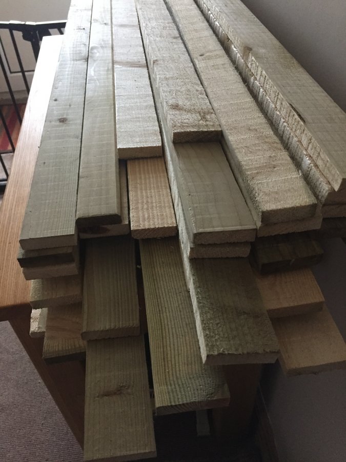

i am preparing the materials for a 3ft high hit and miss fence to sit on top of a 3ft single brick wall.
What would you use to attach the vertical wood to the horizontal rails? Stainless steel nails or galvanised nails? Or should I use screws ?
I will make the panels up to then fix to 3x3 fence posts.
Here is the wood:

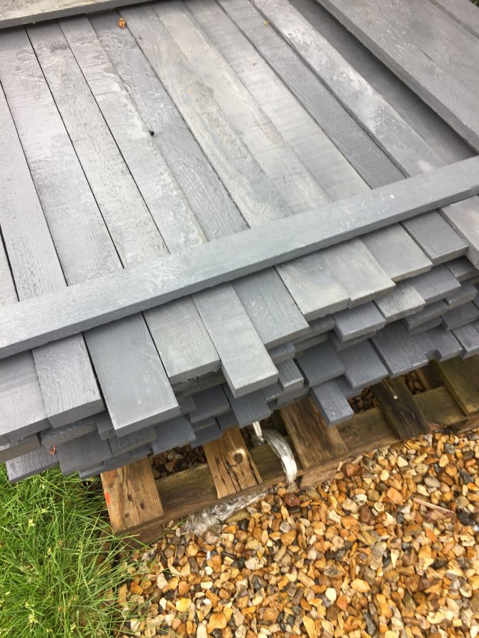

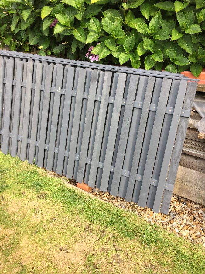

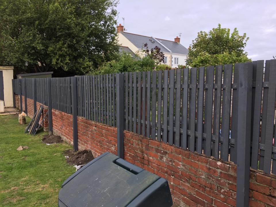

IMG_2096.JPG The fence panels have been built, in the end I went with screws to fix it together, the nails weren't really gripping the wood. To say that all the pieces are different sizes, with it all painted the fence looks pretty good
I guessed it was going to be more irregular, nevertheless, looks smart, well done! What did you paint it in?
Thanks. It has been painted in the Cuprinol Ducksback, that was the worst bit of the job!!!
I have just added up the costs and £125 for the fence and posts, not bad for 16metres of fence.

Good job, well done. Great when people post feedback or photos of a finished job.
