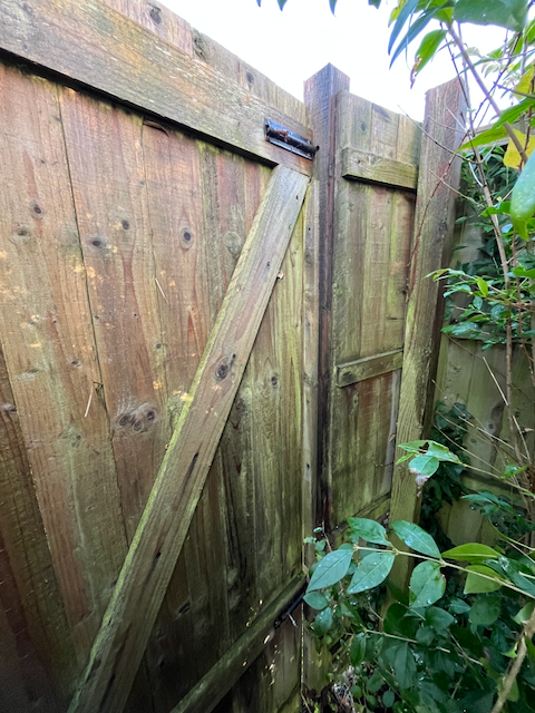

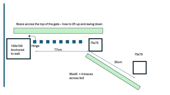

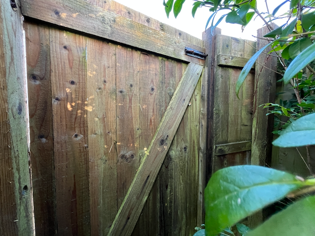

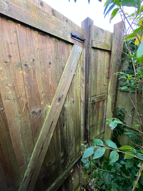

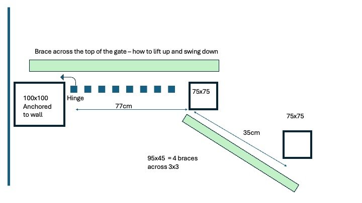

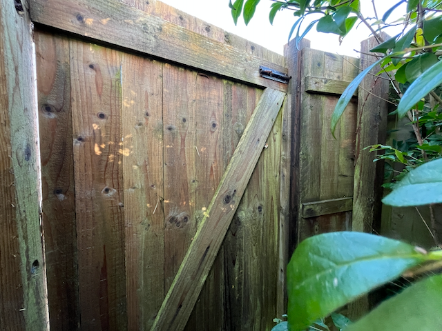

i'm adding a very heavy 42.4mm galvanised black steel pole - mounted on a fence post - thats in ground with metpost
the post is 2m High
I have 3 brackets - 1 will be at the bottom of pole and the pole sits in it - the other 2 are brackets for the pole to pass through - so in that 1m length will be 3 very heavy duty galvarnised bracket
4x4 on wall using anchor bolts resined in - 3 of them for a 1.5mm high 4x4
then a gate 75cm across to a 3x3 metpost - which is where the POLE will be mounted 3m high but 1m brackets on the fence - so 2m in air for a weather station - onlt the anemometer will be at the top - the control unit will be about .5-1m above the fence - so 1.5-2m on the pole
Then another 3x3 post is just 35cm away - all cladded between the posts with rails and wood uprights - didnt measure thosoe
I'm thinking of using some 95x45 that i have and putting thos across the 3x3 - but at an angle - maybe 3 or 4 of those
also a brace from the 4x4 across the gate to the 3x3 - but would be good if i could lifth that off and swing down - not sure how to do that - i'm only .5km from the sea
i have attached a jpg - the green is my proposed plan
any thoughts

Hi! Sounds like a solid plan, especially with that sea wind. Linking the two 3x3 posts with the diagonal 95x45s is a great move—it’ll create a rigid triangle and stop the Metposts from rocking under the mast load. For the drop-down gate brace, I’d just use a single heavy-duty coach bolt through the wall post to act as a pivot. Don't tighten it fully (use a nyloc nut), and it’ll swing down perfectly. On the receiving post, just make a simple wooden slot or 'U' bracket for it to drop into. Lift, swing down, done. Good luck!

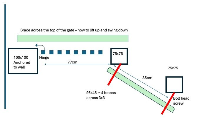

ok, simple as that in fact thats made me think again -
i can just put block on each post and a straight bracket and then the brace just drops over that and will stop side to side as well as back and forth - or as you say just drop in some how - happy about that

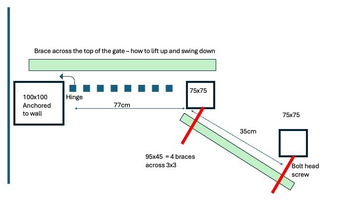

but where the angle of the brace goes over the far rght 3x3 - can i just leave it touching the edge of the 3x3 and screw (bolt srews into the post
i dont want to try and cut things at an angle etc etc

Glad the drop-down idea helps! For the diagonals: Don't worry about cutting angles. It’s just extra work. You can absolutely just let the 95x45 overlap the post and bolt it through as is. Just use Coach Screws (Lag bolts) with a nice big washer. The washer will grip the wood tight even if it's sitting at a slight angle. Simple and strong.

Saturday - i had a go i put the centre piece in and it went well - BUT the top one all twisted - so decided i would mout with 2 coach screws each side - 100mm M8 - which i only purchased Sunday
I will be mounting the diagonal 95x45 wood across the 2 posts and each end will now have M8 100m A2 coach screws - and penny washers

I am in a coastal region. Salt spray in storms attacks outdoor steel. I previously used metposts but they rusted away to lace. They are not galvanised. Concrete spurs last fine.
Ordinary coach bolts and BZP studding on the fence posts rusted through and broke.
I now use stainless outdoors.
For the bracing lintel across the top, a bolt at each end will hold it rigid. When you want to tilt it down, just remove one. This is easier with a bolt (with a nut) than a coach screw (with a wood thread). Though I actually use hex headed bolts.

i have all A2 coach screws
i decided not to bother with the tilting brace - I purchased some flat coated brackets
So i will standoff the same as the wood i use for the baricade and notch it so its very firmly fixed in place
