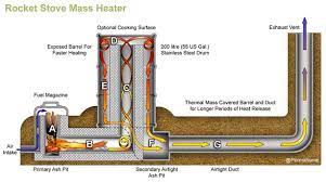

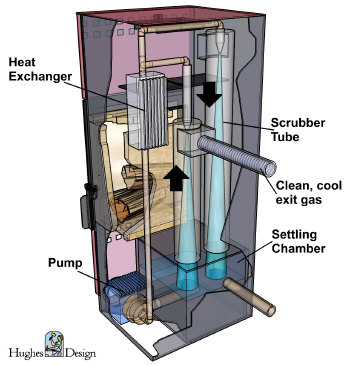

The rocket
was claimed to work well, but not seen one in use, these Hughes Condensing Stove 2 small.jpgwallnoefer.PNGare claimed to burn efficiently, however one would need some UPS for those fans and pump, should they fail and we would have a big bang. I was involved with the set up on my sons narrow boat, he had a rayburn stove with side boiler, but in a narrow boat no where for a header tank, so he used two 12 volt DC pumps, designed so if one failed the other took over, however not sure even with that is would comply with the RCD? (Recreation Craft Directive)

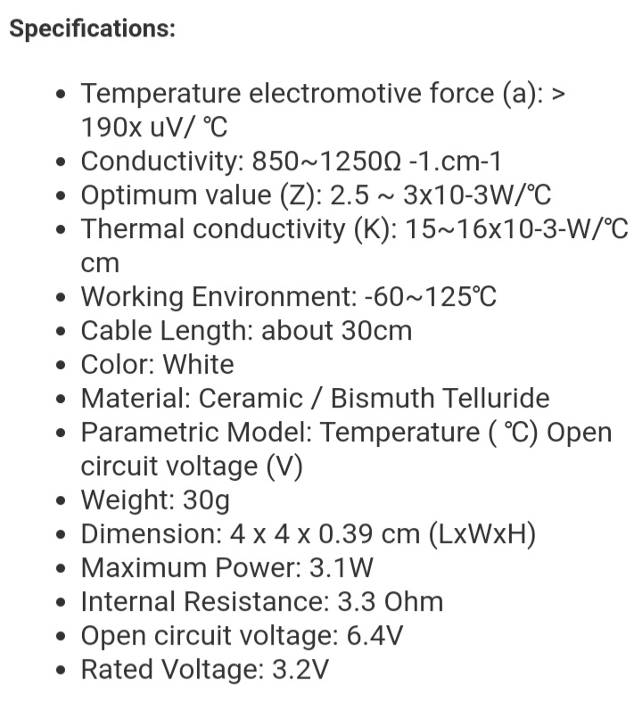

Here's an example for the specifications of a typical 40x40mm peltier...
With a rated voltage of 3V, this may not be a suitable power source for PC case fans.
Basically, peltier based stove fans are the form they are, because that is the optimum design to get them to operate.
A setup to operate a bank of PC fans will require a slightly more unorthodox approach! :)

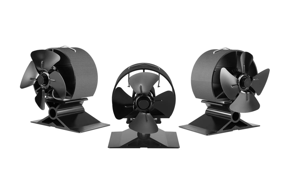

There are many heat powered fans designed specifically for use with stoves
One of many suppliers is
