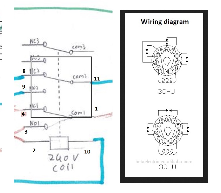

Hi all,
I'm currently in the process of building a ups to back up a cctv system. I have been using this as a guide http://www.instructables.com/id/Super-Simple-Super-Cheap-DIY-UPSCCTV-system-fro/
I've got as far as the relay and I'm now stuck as this guide does not explain it very well (not at a dummies level any how!) This is the relay I have (please see photo attached) I would like to know how to wire this to the mains as well as the inverter, as I'm a little lost of which pins to attach the wiring to. Any tips or advice would be greatly appreciated. Thanks Joe

Against my better judgement this is the terminal numbering on that 3C-U relay. Ensure that the contacts are break well before make otherwise with that simple circuit when the mains restores and the relay energises there is a risk of mains being applied to the ouput of the invertor. That could destroy the invertor.
If the CCTV will work properly on the simulated sine wave from the invertor then it would be more sensible to run the CCTV from the battery and invertor at all times and use a float charger to supply the UPS with 12 volts and keep the battery charged.
Hi Guys, Thank you for your reply and advice. Apologies for the basic questions but this is a bit like learning a foreign language to me! If I do not use the relay I would just have the inverter connected to my deep cycle leisure battery with the battery charger on constant maintenance mode, is that correct? Would the battery not eventually drain out/be ruined? Regarding the relay (if I were to do it this way) I think I'm understanding you, just to be sure I have quickly sketched out a diagram of the relay, inverter and sockets if you wouldn't mind labelling this that would be greatly appreciated, as I really don't fancy potentially blowing the place up. Also regarding the inverter would a modified 300w sine wave be ok? The total load is just under 300w. Thanks again for your advice. Joe

Morning guys, thanks for all your advice. I think I'm going to go scrap the mains and relay and go with the following - a inverter and deep cycle battery with a battery charger connected on maintain to keep it topped up. Regarding the inverter how do I work out what size is needed? Also would a modified sine wave do the job? Thanks, Joe
Morning Joe
That is the best option to be honest.
Will the modified sine wave be OK for the CCTV ? That will depend on the CCTV and its power supply modules. Modified sine waves can have a lot of harmonics ( generated by the sharp edges of the switching that creates the modified sine wave ) and these harmonics can affect the picture quality. If the unit has a fan that runs on 230 volts direct from the input connector then expect some problems as some fans will not run properly on a modified square wave.
I would add at least 25% to the CCTV's rated power requirement and then be prepared to fit a good quality harmonic filter between invertor and CCTV if picture quality is reduced when running on the invertor
If you haven't yet purchased the CCTV then consider a system that runs directly on 12 volts
