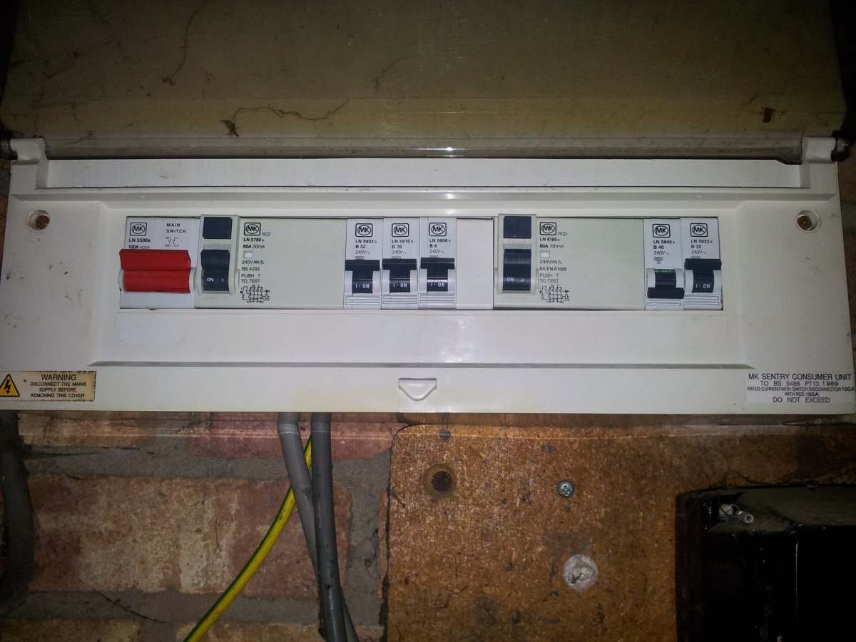

One of the things that the OP is contemplating doing (subject to clarification of the cable installation method) is to change the MCB to a higher-rated one. I think that some would probably argue that such would constitute "creating a new circuit", hence not only requiring 30mA RCD protection (in a bathroom) but also becoming notifiable.
Kind Regards, John
[QUOTE="However, if you did find that some of the 6mm² cable is buried in thermal insulation, something ought to be done about that. Since replacing the whole cable with a larger one would presumably be a pain, the simplest solution, if practicable, would be to 'get it out of the insulation'.[/QUOTE]
Thanks John, that makes sense. The isolating switch is currently wall mounted in the airing cupboard, I intend to change this to a ceiling mounted pull cord switch, this should give me enough slack to move the cable out of the insulation if it is there and clamp it to the wall if it isn't already.
Changing the RCD to a 30mA might not be required, but it's desirable.
If the 100mA RCD is (as would most commonly be the case) an installation-wide one in a TT installation, it might be more a question of adding a 30mA RCD to the final circuit in question than of changing the existing one.
Kind Regards, John

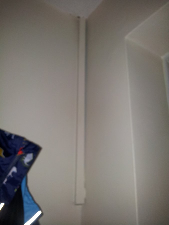

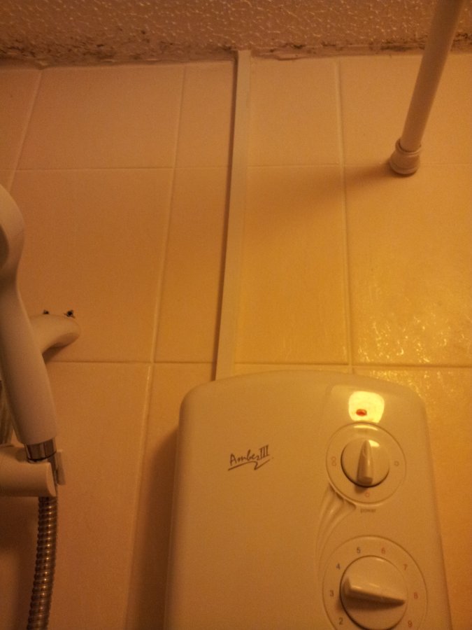

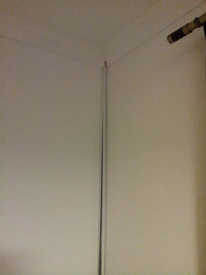

Fair enough. Can you tell us more about the conduit?
Kind Regards, John
It's just plastic box stuff from the sheds, fixed onto the wall, not buried in the plaster. It doesn't go into the ceiling or floor either.
