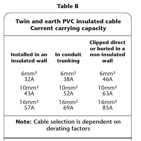

Checking the shower installation manual, it states 40/45A MCB for their 9.5kW model, however if running on a 6mm cable they further state circuit protection should be 32A. So that's why he's suggesting a 32A RCBO?

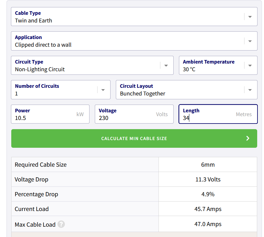

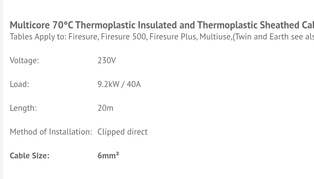

That's 20m clipped direct (no insulation but can be in the wall)

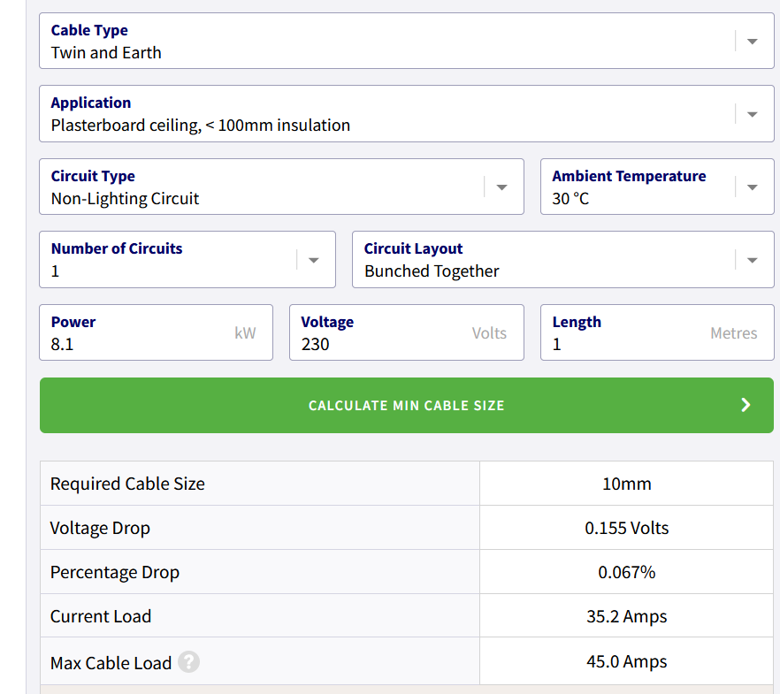

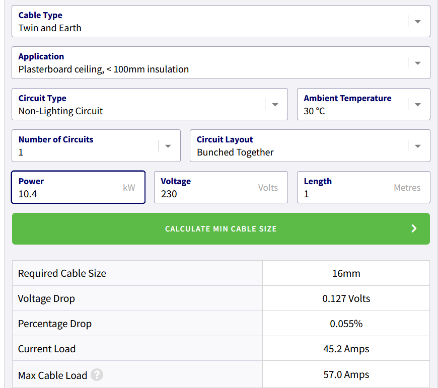

TLCcalculator goes to 10.5KW and 34m clipped direct

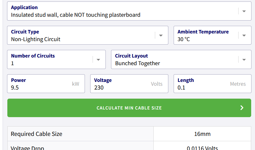

However thatchanges very quickly if insulation is involved

Can you screenshot where it says that on the instructional manual please?

The shower manufacturer doesn't recommend 6mm with 32A coupled to a 9.5kW model. Indeed, they state it's best to use a minimum of 10mm if the cable is likely to run in any situation that isn't ideal.
However they do state 'The current carrying capacity of the cable must be at least that of the shower circuit protection (see Table B).'
