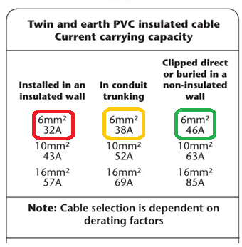

Thanks for further replies. Yes, he advised the tripping was due to poor installation of the isolator switch. Cables partially burnt out due to poor connections, not all of the live cores terminated.

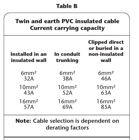

The shower manufacturer doesn't recommend 6mm with 32A coupled to a 9.5kW model. Indeed, they state it's best to use a minimum of 10mm if the cable is likely to run in any situation that isn't ideal.
However they do state 'The current carrying capacity of the cable must be at least that of the shower circuit protection (see Table B).'
Essentially, assuming the issue has been fixed with the replacement and properly wired isolator switch, I would like to know if it's advisable to have the 32A RCBO fitted or just leave the 40A? This assumes 6mm cable left in-situ.
What that table is showing is the maximum current carrying capacity of a cable under various conditions, using Ebee's figures; basically any figure below 40A that on the chart should be avoided so that'll be the red, the amber may just be suitable for the heater if you have 230V but would not be correctly protected by a 40A MCB/RCBO and the green is fine.
This does not take account of voltage drop (cable losses) but at 5-6m it's not something you'd need to get involved with.
Although I'd need to check, I am doubtful any form of cable insulation has been used.
the reference to insulation is regarding thermal insulation, such as glass fibre, rockwool etc stopping the cable being cooled as it warms by the heavy current.

do you agree re dropping to 32A RCBO?
yourself.
I have seen loads of showers with an MCB technically too small for the shower's rating, and they have not tripped in the time it takes to have a shower, over the years sometimes they do degrade, likely due to being overloaded so often, but it takes years.
The MCB/RCBO is there in the main to protect the cable, and the cable takes time to warm up, as does the MCB/RCBO, but we look at the worst case scenario, so the phone rings, someone steps out of the shower to answer it, and the news need fast action, so the running shower is the last thing they are thinking about, so shower is left running.
So with a 40 amp shower on a 32 amp MCB/RCBO the unit will trip, no harm done, but with a 40 amp MCB/RCBO on a 32 amp rated cable, the cable may overheat.
It is an unlikely scenario, but it points to the best option is to use underrated MCB/RCBO rather than chance overload the cable, in fact the shower tripping if used for an extended time, could be seen as a safety feature.
Leave it as is. I have a 9.5Kw which has been running on a 6mm/32amp MCB, for many years and without any issues. The thing about a shower, is that they only run for a matter of minutes, rather than continuously loaded. It takes time for the cable to heat up. Even less chance of issues, if the shower is a temperature controlled version, which throttles the power down, to control the temperature. In the heat of summer, is when the ambient will be higher, and the current drawn least.
