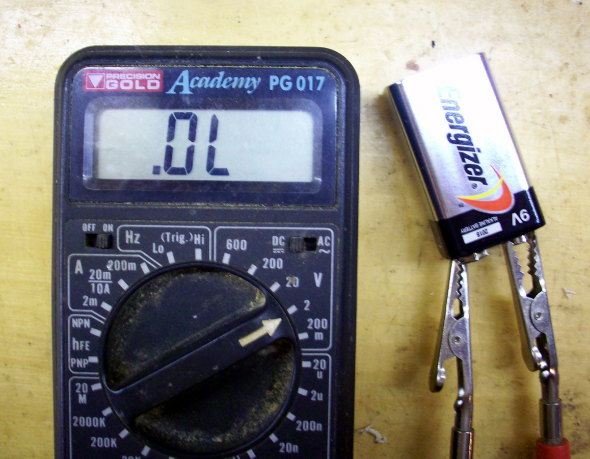

Morning all. Quick one to settle. 'OL' displayed on a DMM when reading Voltage. What is OL? I believed it to be Over Limit. Mate suggests Open Loop.
Thanks in advance. Dan.
In my experience it has meant Over Limit.
However, depending on the meter brand, when measuring continuity, no continuity can be displayed as "Open Loop" or "1", or sometimes even the infinity symbol (a sideways "8").
Check your meter instructions.
Never managed to get OL shown on voltage range on my meter. Ohms and diode test yes but not volts. I suppose diode test is volts in a way. But an open loop means it is over the limit any way so what does it matter. Over limit would seem a good phrase to use.
Maybe you have an auto-ranging meter? With a traditional switched-range meter, it's the easiest thing in the world to get an "OL" display - this is what happens if one tries to measure 9V on the "2V range" ....

Some display an "OL" indication for overlimit/overload, some displays have a tiny "OVERLOAD" or similar message appear above or below the main readout, others just use something like a single "1" displayed at the far left with the rest of the numeric display blanked.

Thanks all. I've shown him this but still thinks he's still right. I'm sure my fluke meter years ago said Over Limit in the instructions too but I can't find a copy. And yes, my cheapy ones now just show '1'.

And in that case, one could argue that "Open Loop" might well be an appropriate description with an open circuit and inifinite resistance. But clearly it's not when it comes to measuring voltage or current.

Suggest to him that "Open Loop" really makes no sense in relation to voltage or current measurement (although, as has been said, it could for resistance measurement) - and, if he still doesn't accept it, ask him what on earth "Open Loop" could mean in relation to voltage or current measurements.
