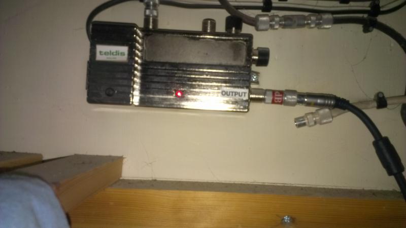

"Next, start by connecting the TV to the output of the Taldis box. Power back up and do a signal check. The quality will drop a little but you should still have plenty enough to get good TV picture. If you have a problem here then it's either the the Taldis power supply or the Antiference box." as in picture below.
I did a channel scan. It found channels but couldn't display any of them. TV said "no signal" exactly the problem I was having when this TV was connected downstairs.
So, this now isolates it to the Taldis and/or Antiference box? How do I know which one? I could replace both if you could give me some suggestions.

Here are the three connections into the black Antiference box
From the left:
First cable comes from the splitter attached to the Labger box.
Second cable comes from the top left Taldis unit at the bottom
Third cable disappears off via the trunking
Also the Output cable on Teldis also disappears off into the trunking.

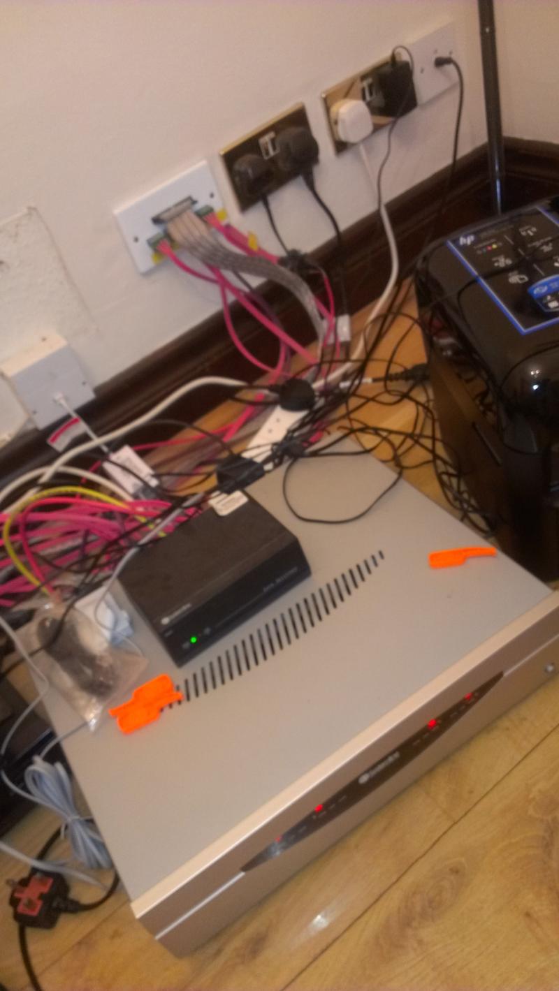

Re - IR pass etc- There is a separate music distribution system in the study that's a mess of wires- the vendors had told me that I could use the remote control pointed at the control panels to change the satellite channel - I attach the pictures below. Havent got round to giving this much thought yet as I have only managed to get the satellite channel on upstairs TV thanks to you guys. Should've got them to show me how these things worked.
