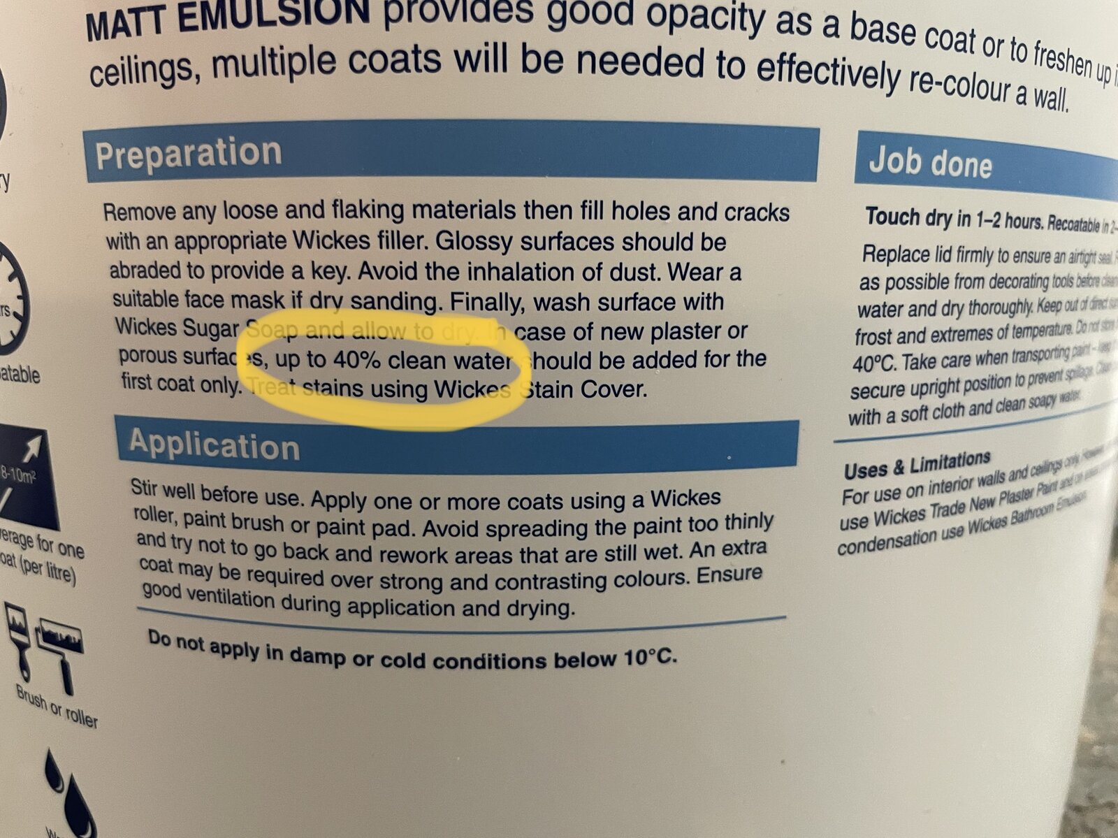

I had walls and ceiling skimmed and I applied a mist coat of
https://www.wickes.co.uk/Wickes-Matt-Emulsion---White-10L/p/145119
3 litres of paint and 2 liters of water (instructions indicate max 40% of water)
This is after a first mist coat and drying for a week
If I rub my hand on the wall I’m left with a fine white powder
Do I need to clean it with a damp sponge before the next coat?
Can I apply the finish paint or do I need a second mist coat as it looks a bit patchy?

I would be inclined to use a wet sponge, but you may find that it just washes all of the paint off. If so, re-mist with a decent paint (again, as per the manufacturer's instructions).

40% water was the manufacturer instruction for that paint, it was pretty thick before adding water; I didn't check the reviews, but I imagine some may come from people who forgot to stir before use
How do dilution ratio work for paint?
What does 40% mean in this case?
10 liters of paint + 4 liters of water?
6 liters of paint + 4 liters of water?
I’ve assumed to be the second (40% of the total) but I just want to check

You are correct 6 parts paint to 4 parts water.

Personally, when mistcoating, I apply dilute, wet on wet. By that I mean that I allow the mist coat to soak in slightly and then re-roll straight over it. It provides a more even coverage and doesn't leave the customer thinking "OMG my walls look awful".
I am still a little concerned about the dusty finish. I guess toy can select a small section, apply a full fat coat, let that dry and then apply a second full fat coat. If the second full fat coat does not pull off the first as you roll it, you should be OK.
I have cleaned all the dust with a damp sponge and then applied a second mist coat at a lower ratio (1 part water and 3 part paint, so 25% instead of 40%)
The dust after this second mist coat was minimal so I have applied the first top coat
