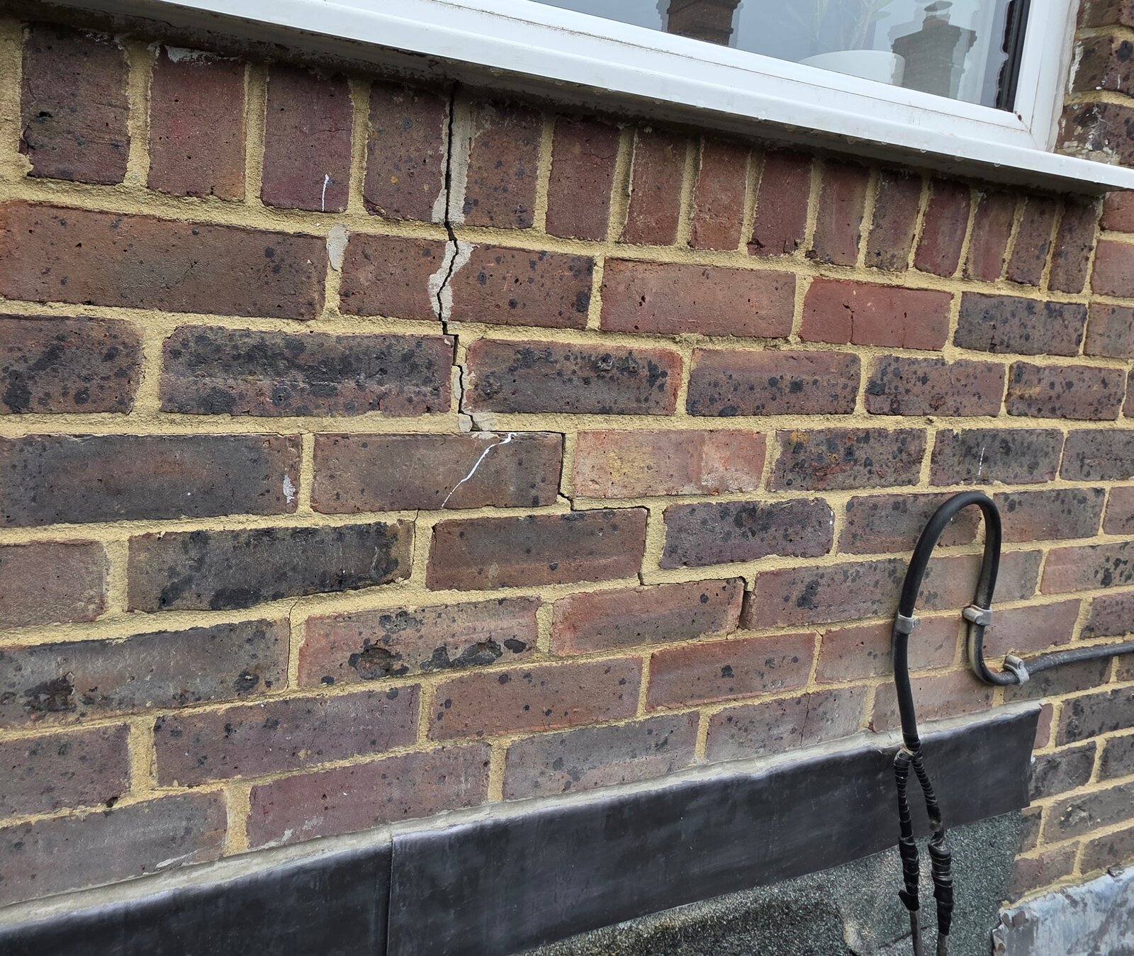

Hi all,
I've got this crack under my landing window; it appears to have been re-pointed at some time although it looks like it was poorly done. I moved into the property in 2022 and the surveyor flagged the crack and said he believed it to be settlement or from the replacement of a window and to have happened some time ago. He also flagged a step crack under my front room window but that is still a hairline and is no cause for concern; it just needs repointing although I will install helical bars to avoid any long term issue.
The image of the crack looks similar to the picture I took (hasn't moved dramatically in 3 years) albeit, my picture is much better quality to the surveyors picture in the HBR. Apparently in 2022, because of the heat/weather subsidence claims have gone through the roof. Do I need to get a structural engineer in, or can I just clean up, install helical bars and re-point? The window looks out to a flat roof side extension and I recently replaced the flashing because it was previously bitumen and was disintegrating; therefore I wondered if water may have gotten in this way over time. Apart from this crack under the window, I cant see any other cracks externally. However, since moving in, cracks have appeared internally, again these are hairline so I wondered if they may be todo with the poor pointing repair..
Whilst replacing the flashing, i also saw that the sealant around the window was in complete disrepair, gaps etc, coming away, and clearly needs removing and re-doing. I wonder if this is also to blame, and potentially letting in water...
Any help would be greatly appreciated... Thank you.

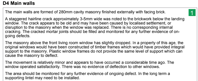

Homebuyers Surveyors Report (2022)
Current crack (2025)

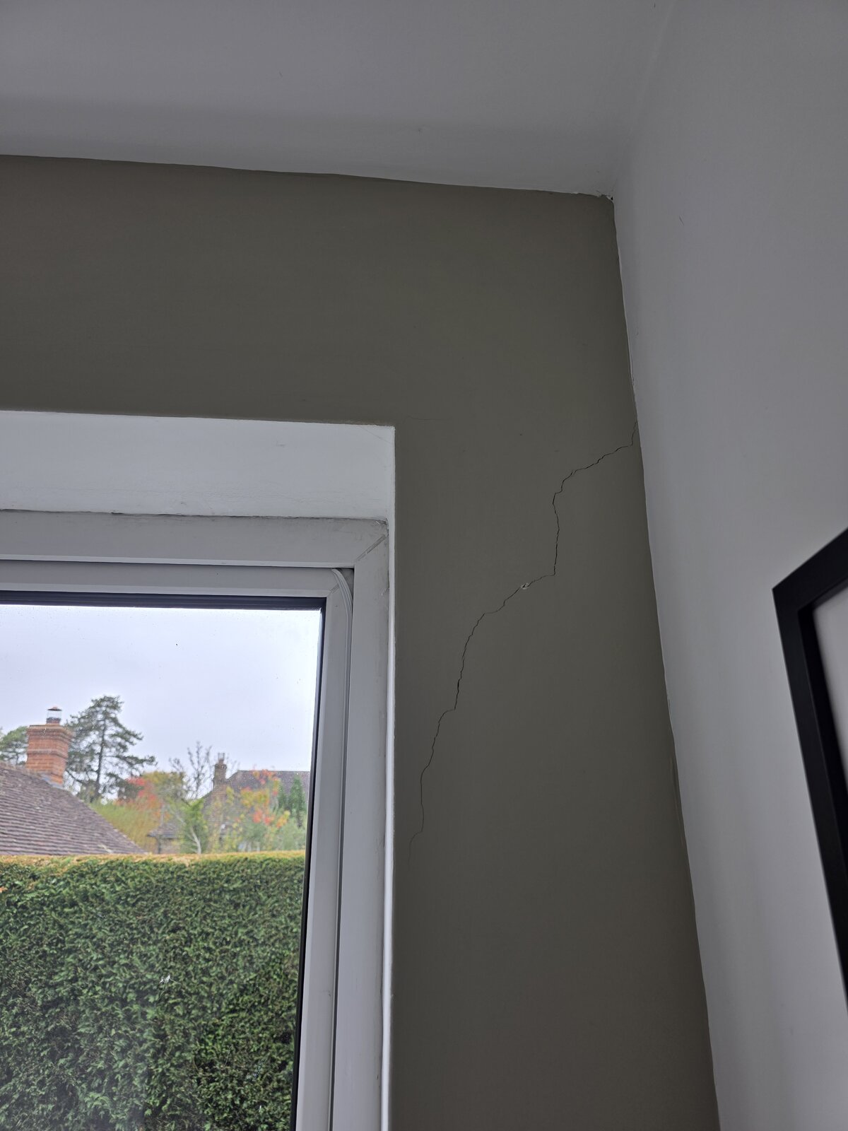

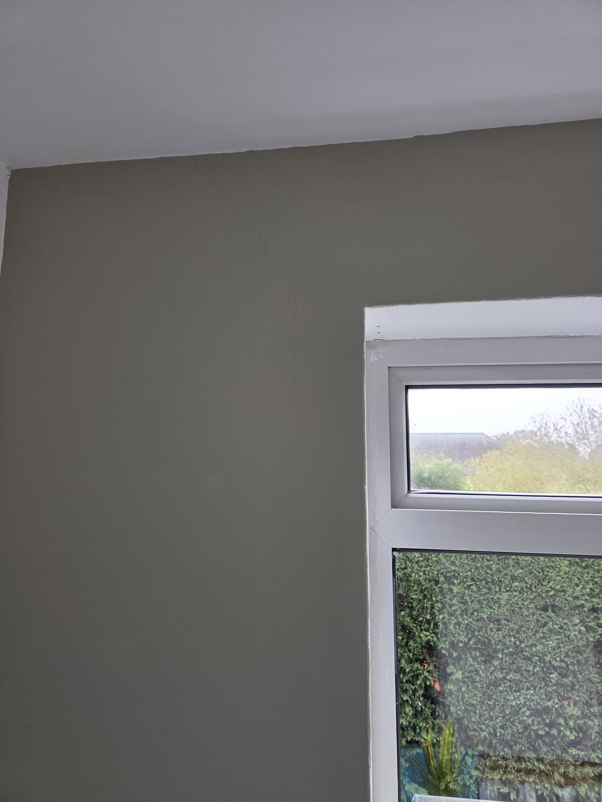

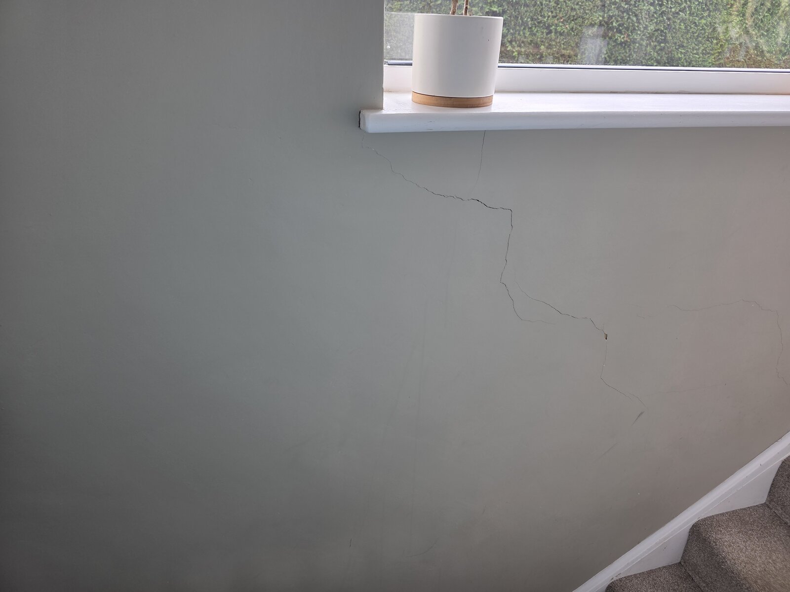

Internal wall
