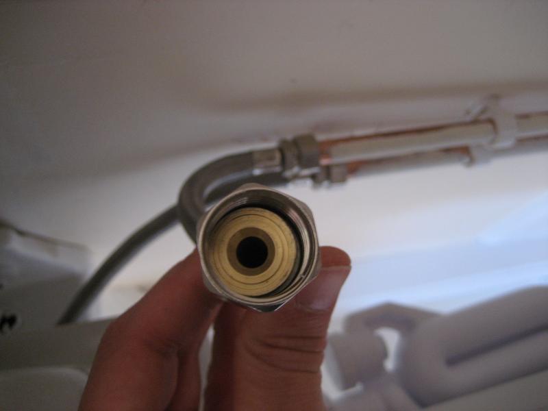

I've a leaking joint where my flexible tap connector connects to the (metal) tap tail. The flex connector only seems to have a metal washer (see pic)
I can't get the damn thing to seal. The surfaces both look sound, I've already tried PTFE tape on the tail thread. I notice some hoses have rubber washers and I notice the metal washer in my connector has a circular slot in it - do you think mine's supposed to have some further washer, or should I try something else?
Ta.
Yes you need a 1/2" sealing washer.
