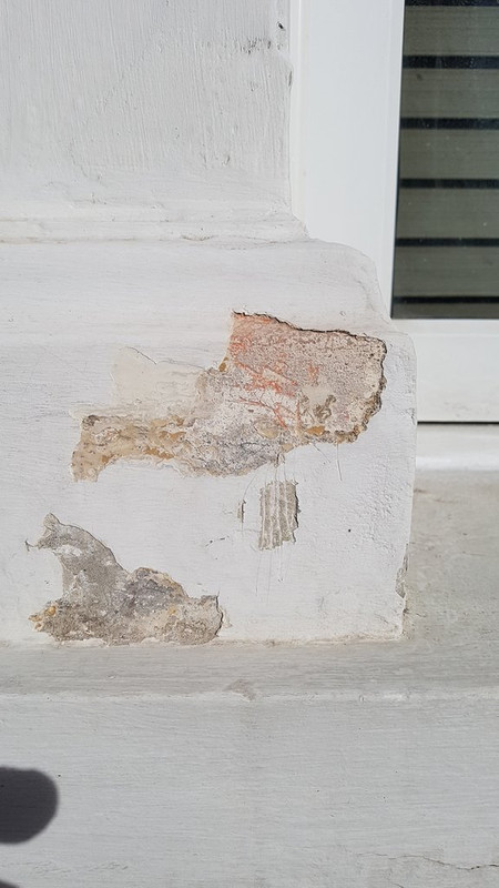

Hi guys. A few questions if you don't mind. I've got maybe half a dozen small and very shallow patches (like about a millimetre depth) of bare masonry stone where I've taken off flaking paint. I've bought a box of Touprelith F filler. Can I spread the filler straight onto the masonry or do I need a primer? If no primer needed, do I need to first wet the areas to be filled? And I believe I've got to allow Touprelith F two to three days to cure before painting? And can I paint Sandtex masonry paint straight onto the Touprelith without a primer?

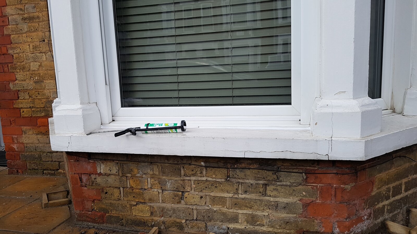

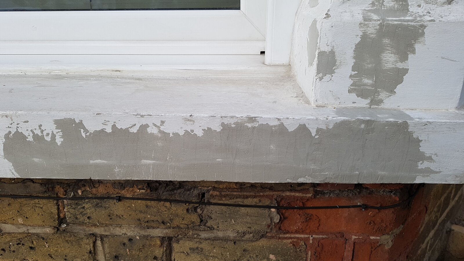

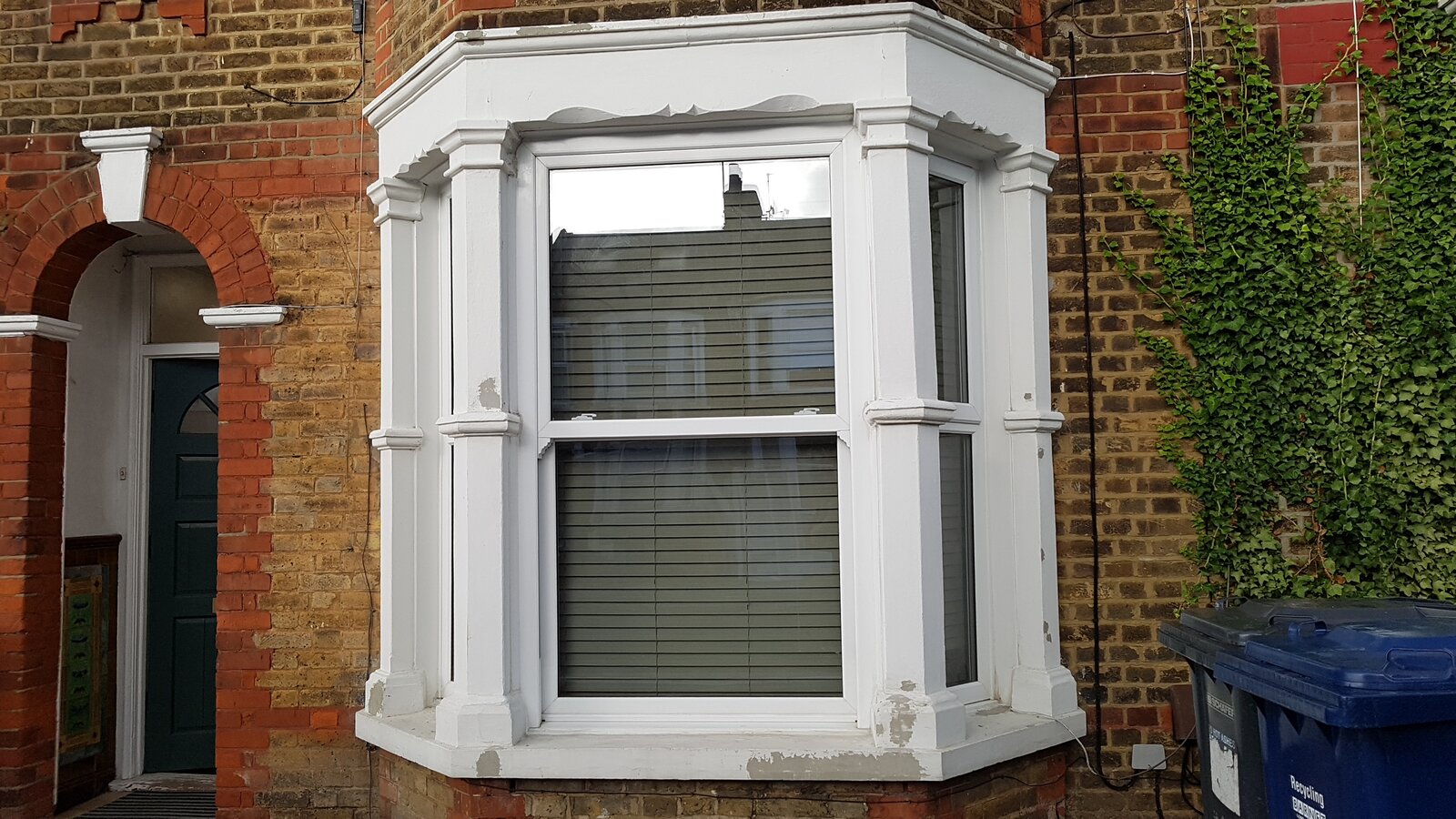

This photo shows most of the areas I filled. Along the very top of the masonry as well.

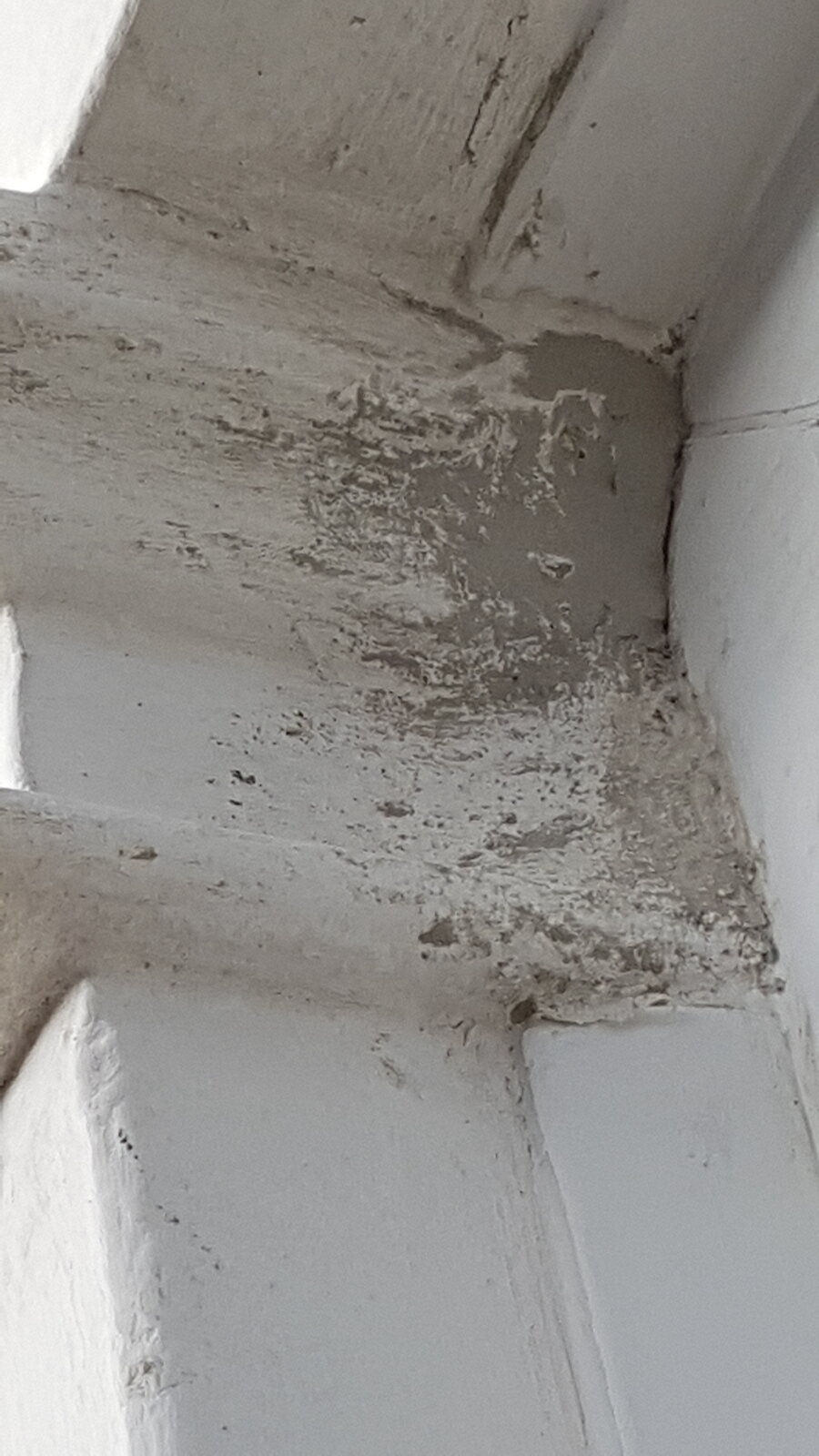

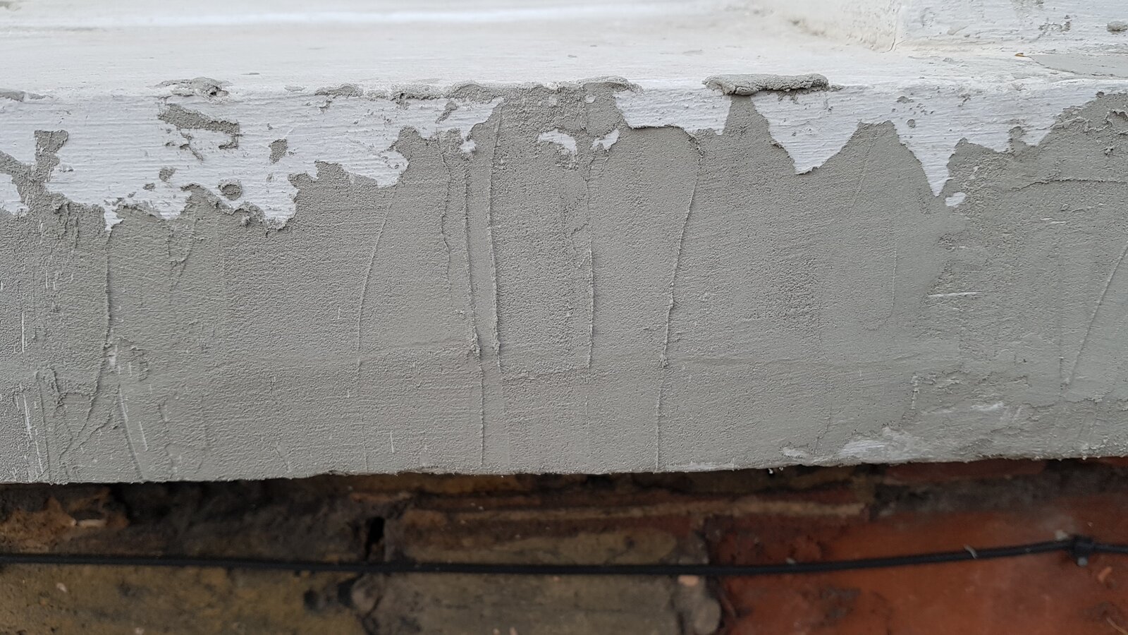

Here are some horizontal cracks I filled. I opened the cracks a bit. Third photo shows after I sanded but looks like I didn't quite sand it enough and need to smooth it further.

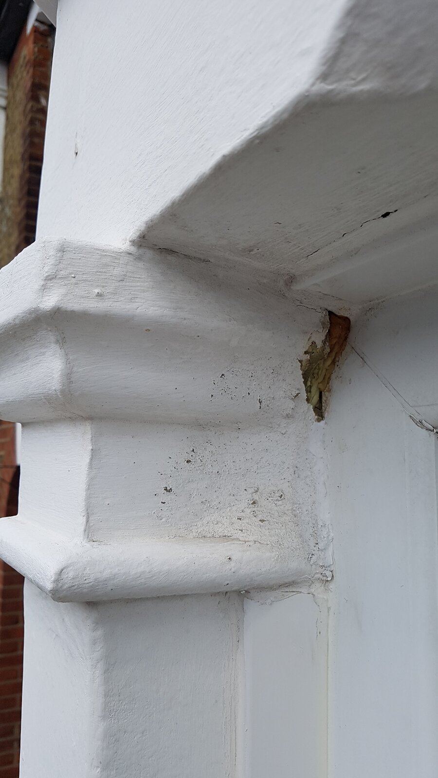

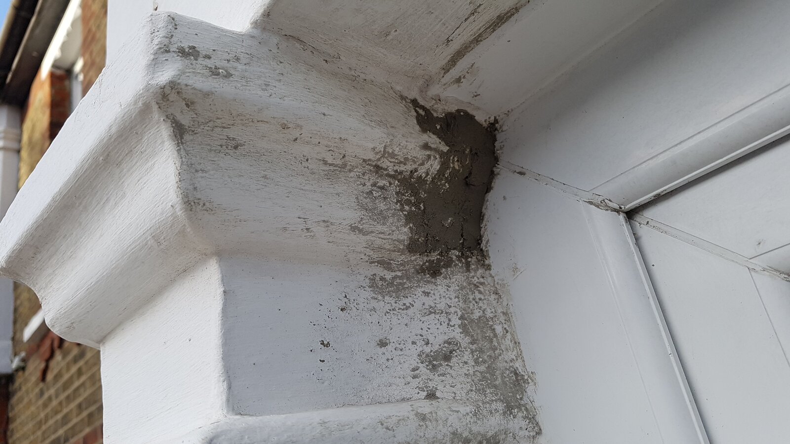

This top corner shows exposed foam and was tricky to stuff filler into. But after sanding I've managed to shape it a little.
