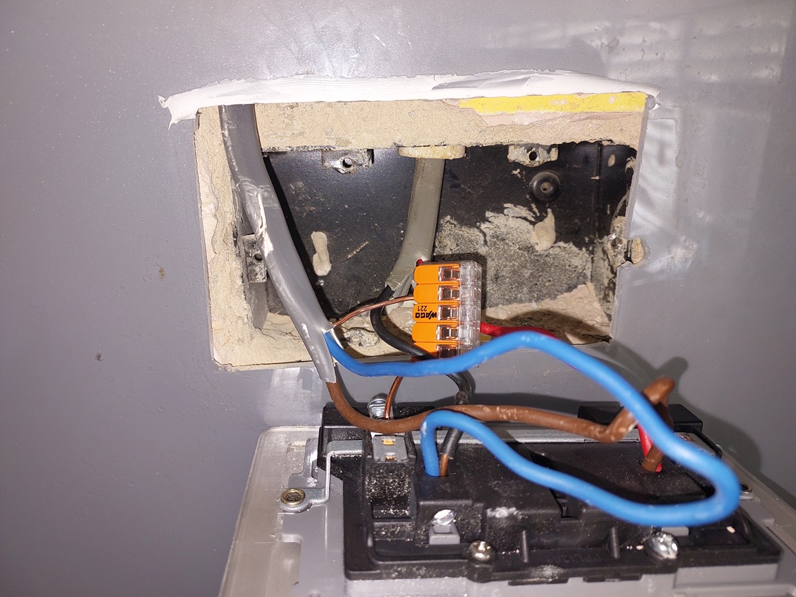

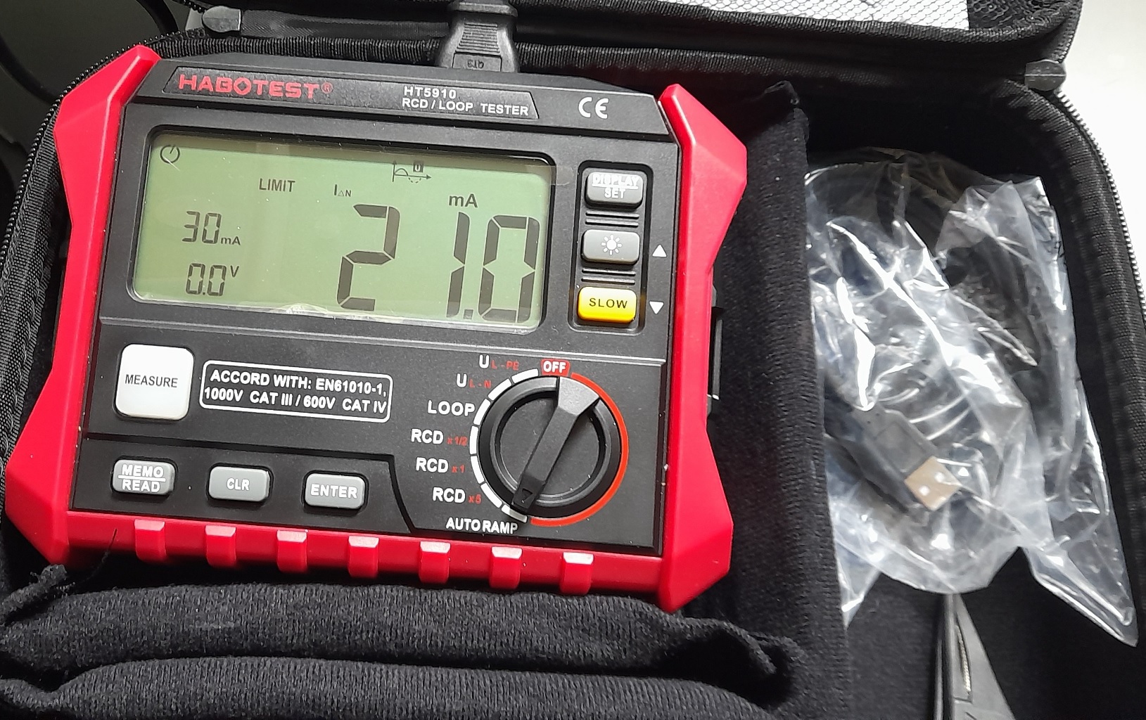

I looked at these
and one of these
and it seemed actually cheaper to get the second option, which in fact, failed to give a good loop impedance reading. The RCD test was A1 but not the loop impedance test.
So we are looking at around £100 to buy or hire equipment to test the installation, and it seems likely it would cost less to employ an electrician to do the testing.

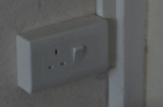

But with this case, (not any similar cases) the adding of a fan is hardly going to overload a circuit, even if technically wrong, so how pedantic should we be?
It seems unlikely the fan will cause a problem, but technically it should not be fed from a spur. It would not worry me, but it does not comply.
