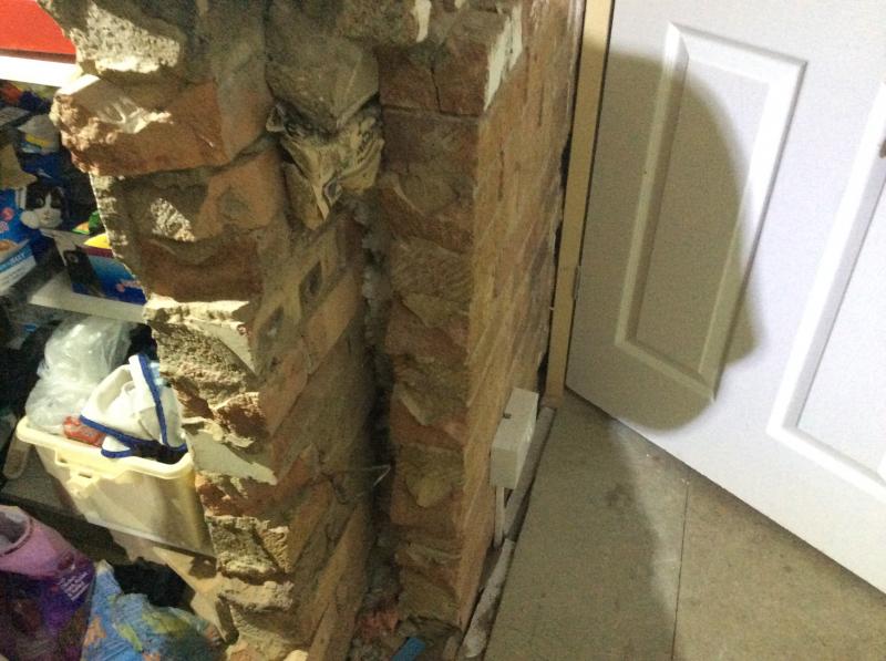

Do I need to close the cavity
17 Nov 2014
4
Essex

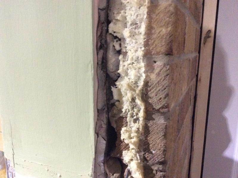

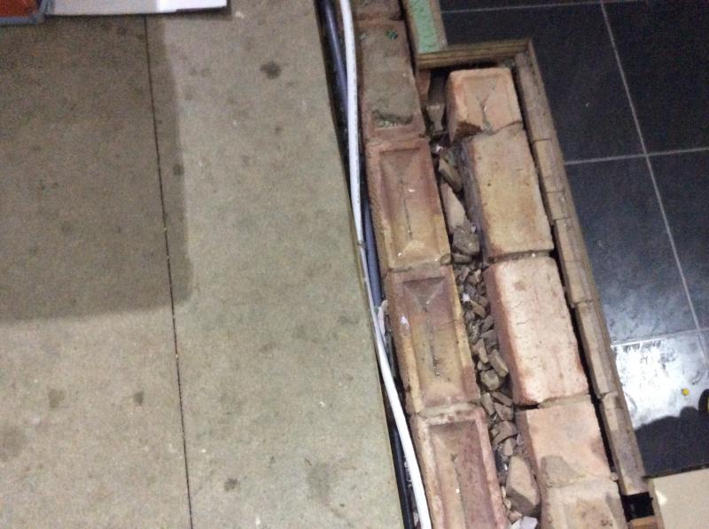

I have recently removed a back door and windows with a small wall underneath it, knocking through to an extension, but i am now unsure what to do with the exposed cavities, there is a main one which is 50mm wide from the wall which was knocked out, the cavity on the floor and a slim one from the removal of the door and window, any help would be appreciated
Current recommended practice is not to close the cavity with masonry but to use an insulated cavity closer. If you can't get one the right size a good alternative would be mineral wool (or inject foam as long as you can do it in a controlled way) with a vertical length of dpc. Also check the wall ties. There should be a tie for every course of block within 225mm of the opening. If there are any large areas without ties I'd add a couple.

How about the floor, would I just leave the cavity exposed as it is, and continue the kitchen flooring through?.
