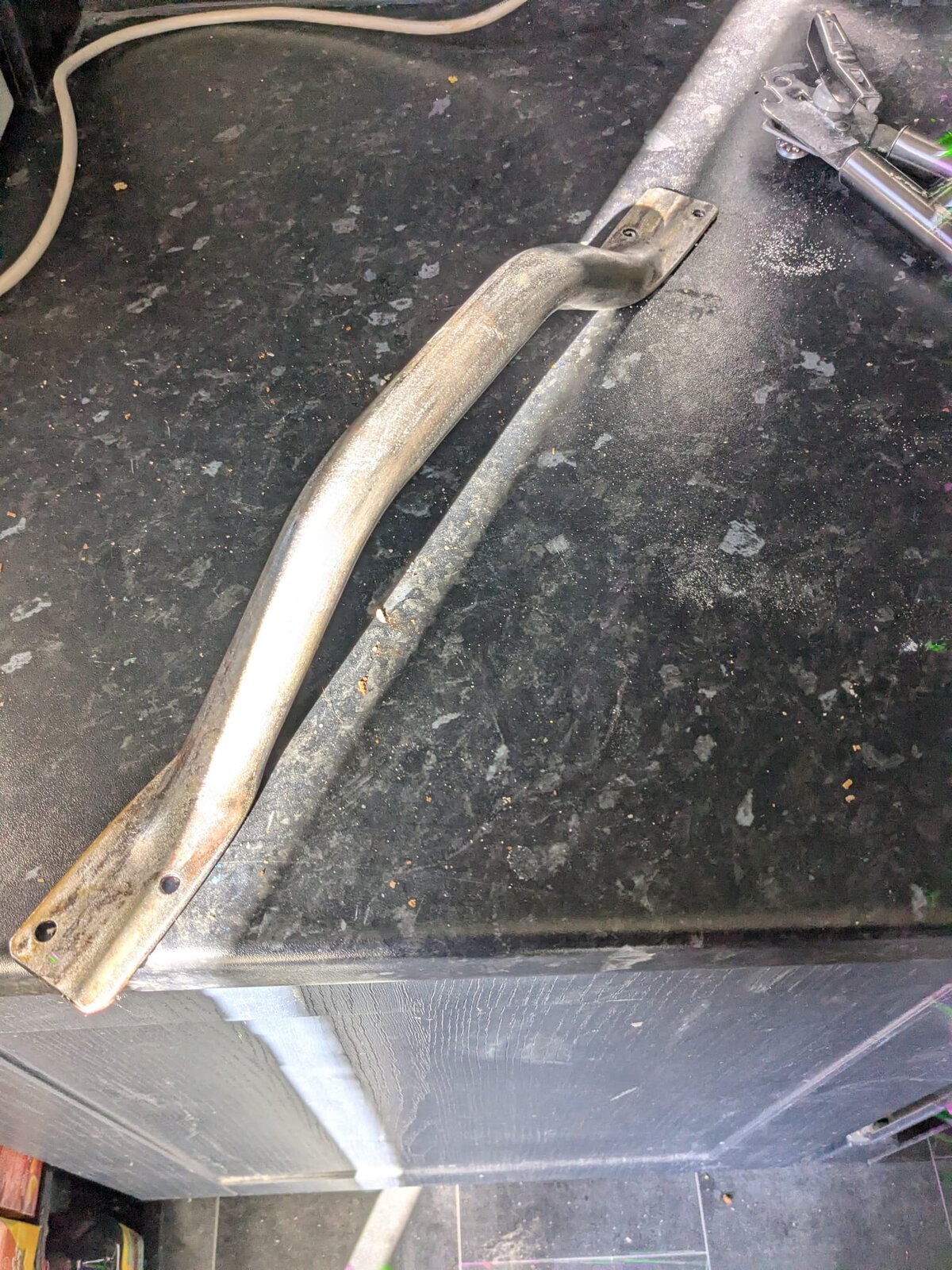

I have here, a metal handrail from my bathroom. The paint had peeled off in places and it had gotten rusty over several years, but it still seems solid

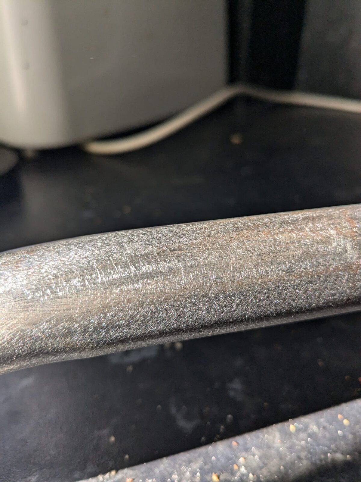

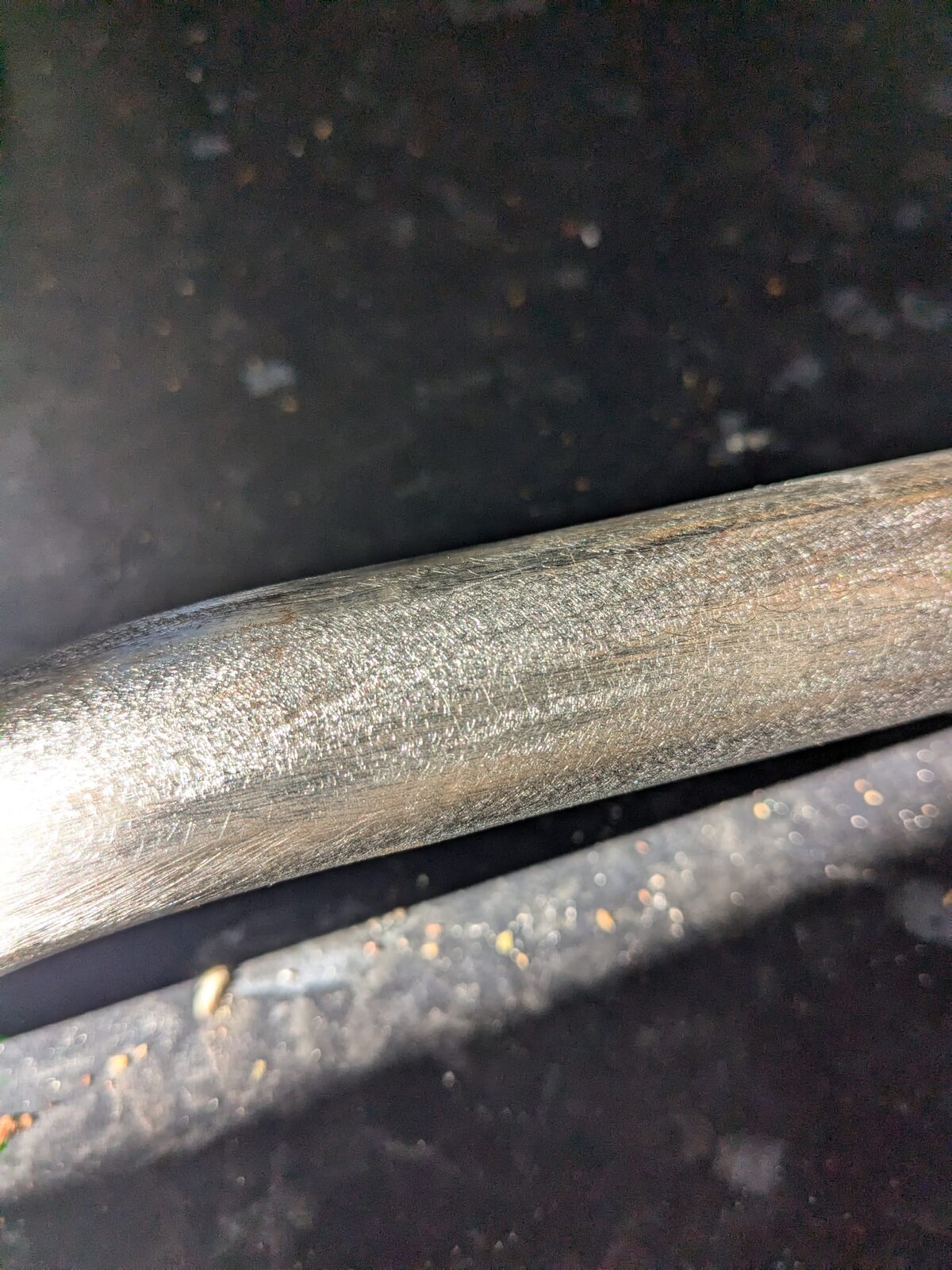

I've taken it down, and spent half an hour running the detail sander over it, gotten most of the rust off, does this seem good enough? I think so.
As you can see, the surface is (now) covered in thousands of tiny scratches, it looks very rough, although it feels smooth to the touch
I'm planning to paint it, i've got some dulux easycare bathroom paint which i used on my doorframe, i'd like to use it here too, match the color
But the question is, can i just do that? Is it going to adhere? My gut says no.
Will i need some specialist metal primer to make this work? i don't have any

If it was mine, I'd head for a motor factors and buy an aerosol of etching primer really does adhere to the metal.
If you want to fill up those pock marks, get a can of high build primer too!

i think the pockmarks you mean are the two screw holes at each end

For pock marks, read tiny scratches!
I use etching primer on any metal, in my case 99% steel and it hasn't let me down at all.......where ordinary primer has.

I would try some fine steel wool on the reverse side of the fixing points before adding your blue to see how it sticks and dries. If successful, which I expect it will be, then lightly abrade the rest to flat the surface and Bob's your uncle
I've always used Dulux satinwood for radiators, works fine and pretty tough, available in any colour to match your wall paint, I would chance it without any primer but maybe that's just me.

i read the label, yes, but sometimes knowledgeable people know that one thing is a good stand in for another, and i was hoping one of the things i had might be good enough for the job, doesnt hurt to ask!
alright, worth a try, ive rolled some on, it doesnt seem to sit quite right, beading up a little, but its not too noticeable, will see how that dries

Great news! This appears to be working well
Of course, time will tell if the paint holds up under actual use of being grabbed and supporting weight
but for now at least, it seems the answer to the thread question is: No, i do not need to prime this metal!
