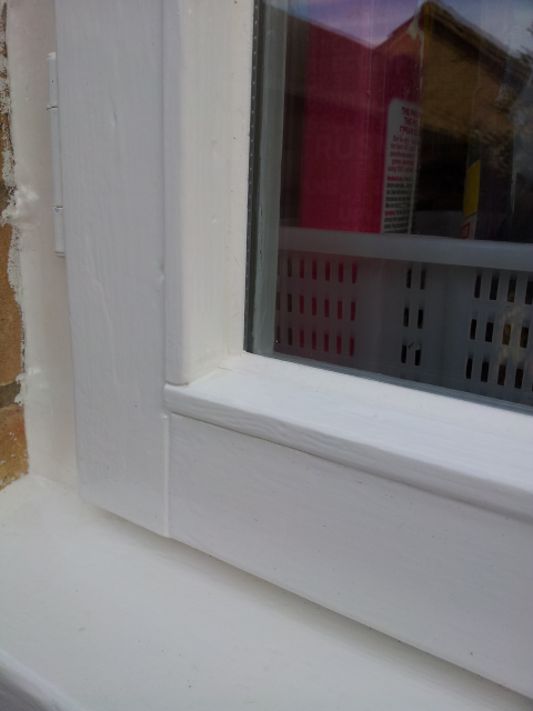

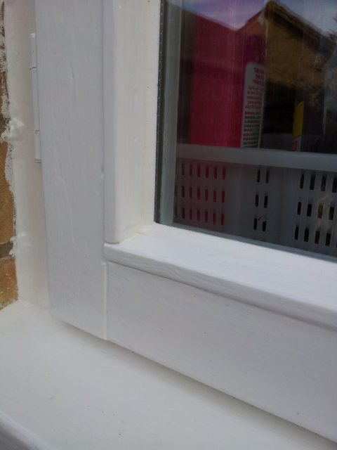

Here's 30 year old linseed putty under paint, under unpainted sealant. Pro windowers can't match this. my seals could be renewed if there is a need. Timber window.

When I replaced the putty with sealant, the sealant width was that of a pound coin because I used the coins to set the gap. The original width must be close to that.
I only paint after priming. No idea what happens if unprimed. Hybrid polymer does react with oil based paint and turns yellow. The sun washes it white again. I only have water primer now. If I use oil based, that will add 2 extra days for any paint job. I go 2x primer and 3x gloss for exterior painting.
When I paint hybrid polymer, I let it cure 24 hours and then prime and paint. I found no problems with that. The sealant beads on my windows are not painted. They might be painted in the future if there is need for repair. I don't see the sealant failing. The paint under it might.
