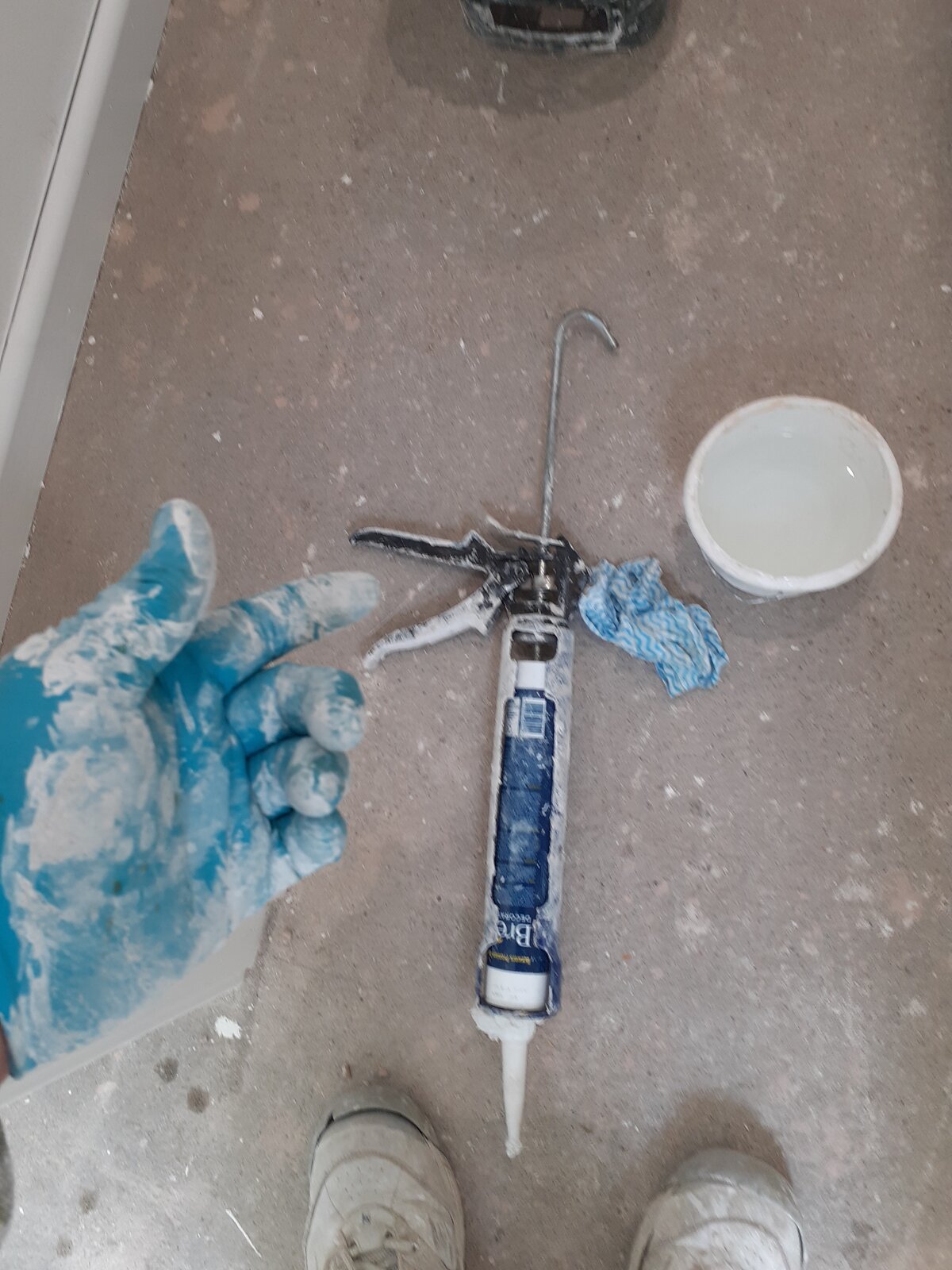

I've been smoothing the caulk with my finger in gloves dipping it in water then using a damp cloth to clean anything off wall. I guess that will work?
