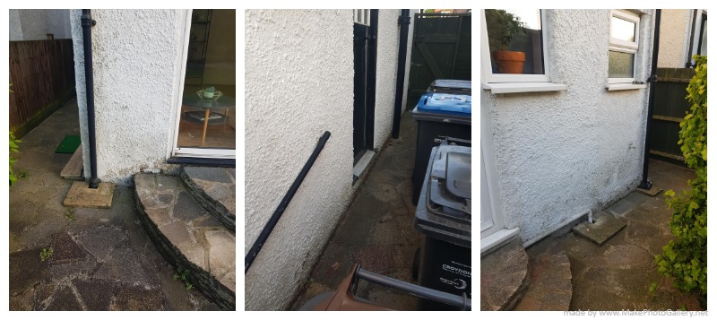

I would have thought the answer to this was yes but i am trying to locate mine to set out my footing depth and cant locate it inside or out.
The house is early 30's i think and solid block construction with pebble dash finish externally. Will there definitely be one somewhere just i haven't
found it yet?
Agreed Woody. I am trying to sketch out for my own piece of mind from bottom of footing to DPC so i have clear in my head where each element will sit. The DPC location was part of that exercise and has confused me. So forgetting the footings for a moment should the DPC be visible? I know that you shouldn't render over it now days but has that always been the case. The architect has detailed the new DPC tieing in with the existing.
It does not matter where the DPC is you can forget it until you get up to DPC level on the new work.
Guage down from the floor level and work to that. You'll need to knock that render off to butt the new wall to the exiting wall, so when you get up to that level with the brickwork, you will find the house DPC.
Then whether you chase the new DPC into the wall/existing or just run it up the wall 200mm or so, is up to you.
Thanks again. Render will be removed probably before i dig footings.

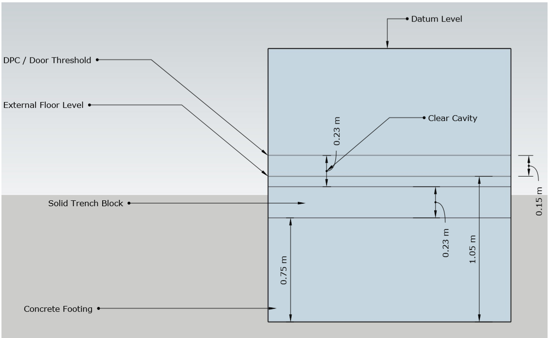

Does this make sense for guageing the footing depth? This is my understanding of what is required from reading various documents.
- Door threshold/internal FFL must be 150mm above external ground level
- 223mm 1 layer of blocks with clear cavity
- 223mm 1 layer of trench blocks or filled cavity blockwork
- 750mm concrete footing to architects specification
Total just over 1m dig below external ground level
It's a 1m dig below external ground level. Do that.
Then the important thing is to gauge down in multiples of brick courses (75mm) or block courses (225mm not 223) to the top of the concrete - as you want it to work courses not have to mess about with split courses or cuts.
The concrete thickness is largely irrelevant as the things to concentrate on are
  • the depth of the trench
  • the level for the start of the wall (which is also the top of the concrete)
  • the finished floor level (ie DPC/top of the wall)
BTW, that sketch shows just one course of bricks below ground level externally. Has that been approved?

So the 750 deep footing on the architects drawings is an indication only i am guessing. I plan to start digging this weekend so i will take it 1m from external floor level, then gauge down from the internal floor level/door threshold (150mm above external floor level) to a full block size to give my top of concrete level.

DPC and FFL are pretty much the same and are at a set level. Your foundation concrete should be set at defined increments down from that level. Those defined increments are 75mm and 225mm.
The make-up of the masonry should reflect your ground levels and dictates the amount of brick courses you need to show so that you don't see any block-work no matter if the ground wanders up or down.
An ideal make-up of masonry would be for the concrete to finish say 525mm below DPC and consist of:
Two courses of dense concrete block and a course of engineering bricks - inner leaf.
A course of blocks and four courses of engineering- outer leaf.
