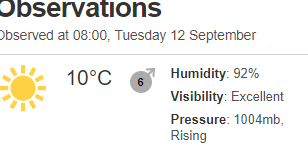

We got one to monitor levels to help combat condensation / mould issues. But, I am not sure it is giving the right reading.
I currently have all the windows open, so humidity should be similar to outside, which it is (I put it outside earlier) but at the moment (8.43am) it is reading 81 - with clear blue skies over Essex.
Although, I may have just answered that by looking at http://wow.metoffice.gov.uk/ ... apparently humidity is higher at the moment?
What sort of figures are you getting in your home at the moment?

Just checked your link and within a couple of miles of us are three stations, reporting the humidity is 63, 73% and 80%
Humidity outside is regularly and normally above 80%, often above 90%. You need to read up and understand Relative Humidity.
To reduce your humidity inside, simple ventilation, without heating is pointless. All you are doing is swapping cold air with high RH, with more cold air with high RH. It is why empty houses, with no heating, suffer condensation/mold/damp problems.
You need background heating, so that cold air with high RH coming in, is heated so that the RH falls, allowing it to 'absorb' more moisture, thus raising the RH. The air is then ventilated out, to be replaced again with cold air. Thus the cycle is repeated ad infinitum.
In a house with high RH, the fabric of the house (walls, floors, furnishings, etc) will have absorbed some of the moisture from the air. It will take some time for the fabric of the building to release this moisture to the air. The greater the hygroscopicity of the fabric materials the quicker and easier will the moisture be drawn out of those materials.
