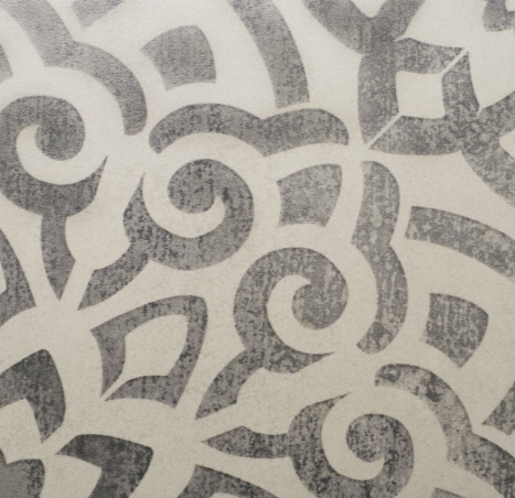

Unfortunately the floor tiles I would like to have aren't antislip. (They have a matt finish and they feel much 'grippier' than others I've looked at.)
Mezzo Fantasia
From what I've read Building Regs doesn't specifically require antislip tiles but safety is an important factor. The tiles themselves are 20x20cm so would the grout lines help with the slippiness? Am I taking a big risk by using them? The alternative is to put in the tray I first bought but by comparison that looks even slippier!

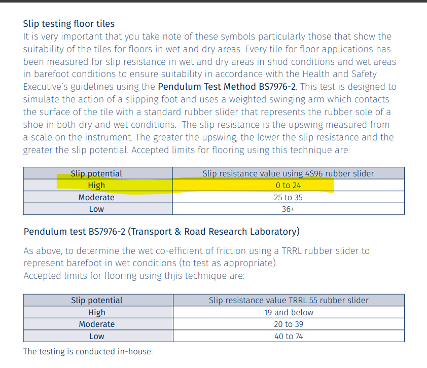

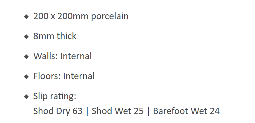

They don’t have an R rating. I haven’t bought them yet but the supplier says they use their own rating -M24- which is medium to high slippage.

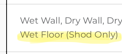

This from online
This is their guidance so I know the tiles aren't recommended for the shower area. I'm just wondered if using them is a complete no-no or whether grouting would help mitigate it. As I said, the polished shower tray looks like more dangerous than the tiles!

I have and it seems fine. That’s what’s thrown me (pardon the pun). I was reading about R ratings and thought I’d check with the supplier, just to make sure. So I was surprised it’s so poorly rated.

@SJRSJR manufacturer says clearly only suitable for use as a wet floor if the passing humans are wearing shoes (what that means, given that I have shoes that are less grippy than my feet..) but consider carefully whether you'll think the tiles are still so amazing if you, or someone you care about, falls and breaks a bone - for an elderly person such an event can hasten the end of their life..
