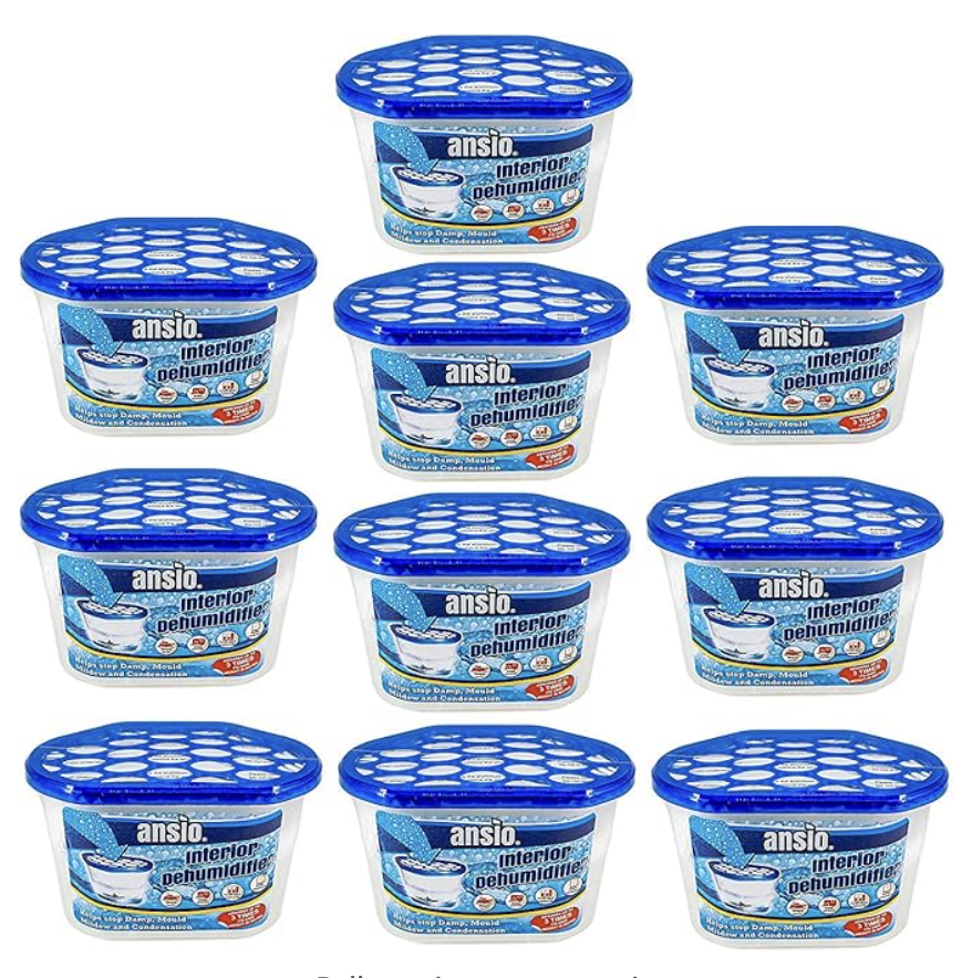

I looked at some of the 37db ones, it's very difficult for me to know without hearing one properly whether I would find the noise annoying, I do seem to be quite sensitive to noise when sleeping. I was thinking of buying 10 of these and opening them all, if this can lower the humidity by 15% that would do the trick

If you are going to use that approach, I think it would be cheaper to buy it in sacks.
