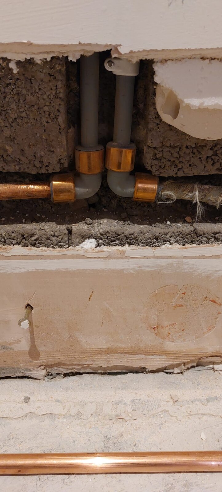

Does anyone the make of these fittings
18 Feb 2025
4
Hi does anyone know the make of these fittings circa 2002 and whether I can use modern push fit fittings on the pipework?
Thanks, Do you know whether Hep20 inserts will work with the pipe?
Osma gold are made by Wavin, same people that manufacture HEP2O so presuming they matched the pipe then it could be grey Hep (may be marked in red writing), if so the insert will fit yes.
Hi Rob, I revealed more of the pipe and it has Osma Gold printed on it, so I am still unsure as to whether the Hep inserts would work. I have emailed Wavin this morning awaiting a reply.
Yeah, it will be the same I would think, no point in them making 2 different types of the same pipe.
I heard back from Wavin Osma,
Hi Tony,
Thank you for your enquiry.
The Hep2o system is fully compatible / interchangeable with the OsmaGold system. Therefore, Hep2o inserts can be used with OsmaGold pipe.
